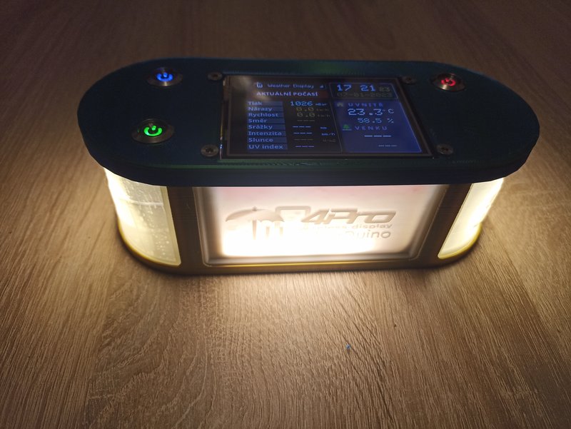

(08-01-2023, 10:29)sano2 Wrote: Hello everyone,
Here is my case or box for Wireless Display with UPS with some decorations
Powered with USB -> 5,5x2,1 DC Jack (Standard USB charger for old phone), UPS with 18650 Li-Ion battery.
Have a nice day
Sano

Very nice case! I've been looking for a ups, which one did you use? I would like to be able to put a raspberry pi, the receiver, and a ups in a case together, although our mains power rarely goes out it would be nice to have the system working when it does.
Thanks,
Zac

Hello Zac,
I have got many UPS boards, in this case I used this one:
https://www.aliexpress.com/item/40011051...1802L0kPRv
I recommended this product. Out 12V, you must use DC to DC step down module from 12V to ... 5V or other. For this I was using this DC Step Down converter:
https://www.aliexpress.com/item/10050035...1802L0kPRv
It is adjustable
The idea is very simple, when you need to move the display to another socket, it does not turn off and lasts for a while.
I will upgrade design, DC connector replace to this:
https://www.aliexpress.com/item/10050042...1802Lcj1Gt
Sano

This small UPS with 5V output is also suitable to use with the 4Pro Dual Band receivers. I'm using them on my units for more than a year, without any issue.
