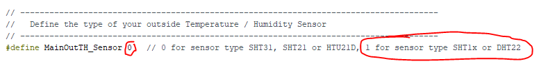

Hi ok2arm
Looking at your RX config I think you need to change the "Define type of your outside Temperture / Humidity sensor" from 0 to 1
Ouu, I Am I... Big Grin Thank !

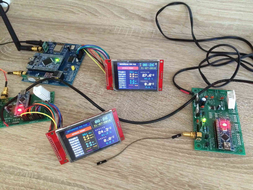

Out of curiosity, can you post a picture of the backside of your TFT displays. I'm afraid that you could have some difficulties with the touch panel, at least with the WD unit.

Hi Werk,
WD unit work well, but RX unit... Sometimes touch not working, but this is not problem, because I need just main screen, also on the others unit...
Pls, can you send me exact rain/wind/direc unit from Ebay, maybee better for help after connection Smile
And, any idea how to connect bigger display for WD unit ?
