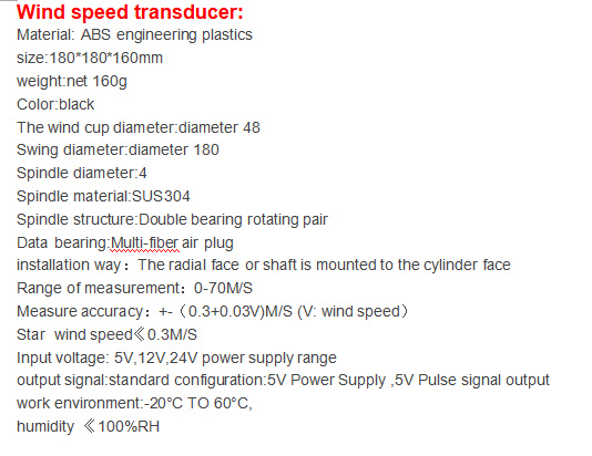

Thanks for quick response, here what I have info wise

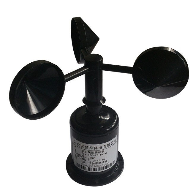

Here is a picture

Are you sure this device produces 16 pulses per revolution? There is nothing about it on the specs.

following more correspondance I have been told 16 pulses gives better accuracy and is standard for this type of sensor.
I also have more info, see attachment
but my maths  is rubbish, I have tried but cant work it out, so if some one can help with the working's out I'd be greatful.
Werk_AG can you look at attachment in my last post, as there is a section in it "calculation formula " would that work out the wind run that you are looking for, like i said my maths is useless.

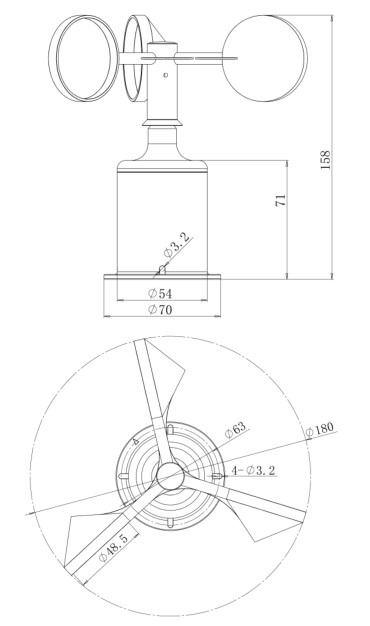

I have also attached another file giving dimensions.
