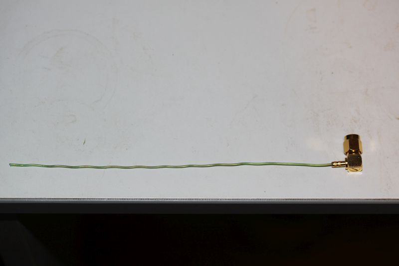

Here is a link to building 433 MHZ Antenna.
1/4 wave 433 Antenna
