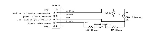

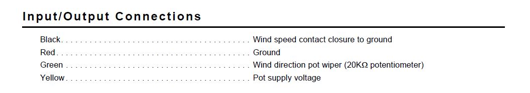

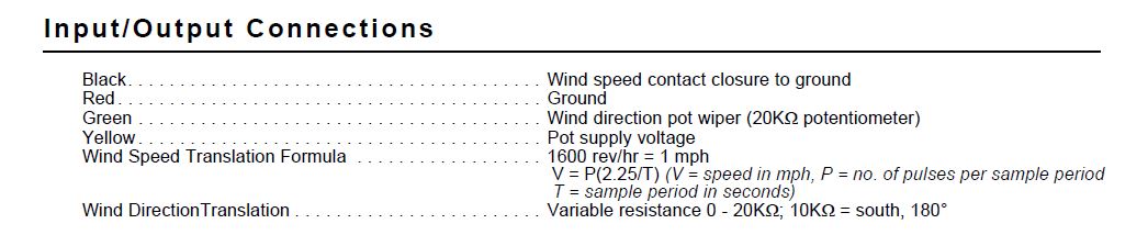

======= Davis Vantage Pro, Part number 6410 ======
Pulse from cup anemometer = Black wire
Ground = Red wire
Wind direction signal = Green wire
+ 5V (Vcc) = Yellow wire
======= Didcot Instrument Company, model DWR205 ======
Pulse from cup anemometer = Black Wire
Ground = Red Wire
Wind direction signal = Green wire (1K ohm; 500 ohms South )
+ 5V (Vcc) = yellow
Not forgetting all Davis anemometers one click per revolution, and older 7911 had no 47 ohm resistors either side of the reed switch.
