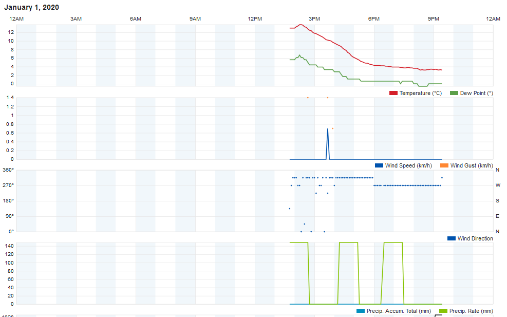

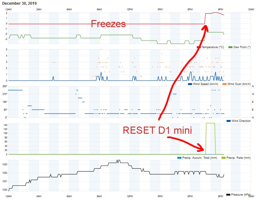

I recently installed WeatherDuino Pro2 Compact RX and wanted to know if anyone has the same problem.
I have an AURIOL H13726 weather station and the WeatherDuino Pro2 Compact RX receiver (Software Version: P2ESP8266_RX_v3.1_b010)
It often happens that the temperature value freezes and is no longer updated until I reset the D1 mini module.
The other values continue to update and the problem is only with the temperature value: everything works correctly on the AURIOL receiving station.

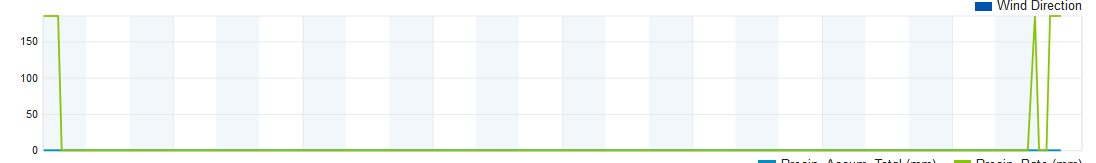

OTHER PROBLEM: when I reset the D1 mini module the Prec.rate value goes to 148.34mm and goes down after about 50 minutes
Thanks to those who can help me
Marco
Hi Marco,
From what I see on the graphs, I would say that the receiver is having some difficulties in getting the RF data from the Auriol station, and even more from the Rain Gauge.
You can try to confirm if this is the case, by enabling this debug option (uncomment this line):
#define PRINT_DEBUG_AURIOL
Then open the serial monitor at 19200 baud and watch the output. If RF reception is good you should see some info at intervals not greater than 2 to 3 minutes, even more frequent for the rain data.
If you see that incoming data packets are sparse and not more or less at constant intervals for each type of data (Temperatura, Wind and rain) you can try play with the receiver or antenna position.
If possible send me a log of what you are getting on the serial monitor.
The precipitation rate issue is what makes me think of a poor data reception from the Auriol rain gauge.
I also suggest that you try to perform a factory reset of the receiver. Go to Menu (touch on the upper left side of the screen) then you will see a button for that purpose. Touch it. After some seconds (up to 10s) unit should reboot itself, however if after 10 seconds it haven't reboot, then press the D1 reset button.
Any time you change the batteries of the Auriol station perform a Factory Reset. This operation isn't needed when changing rain gauge batteries.

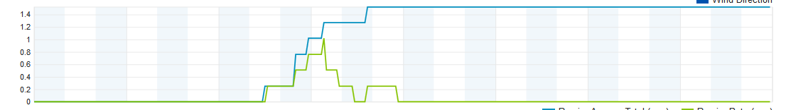

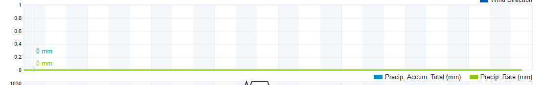

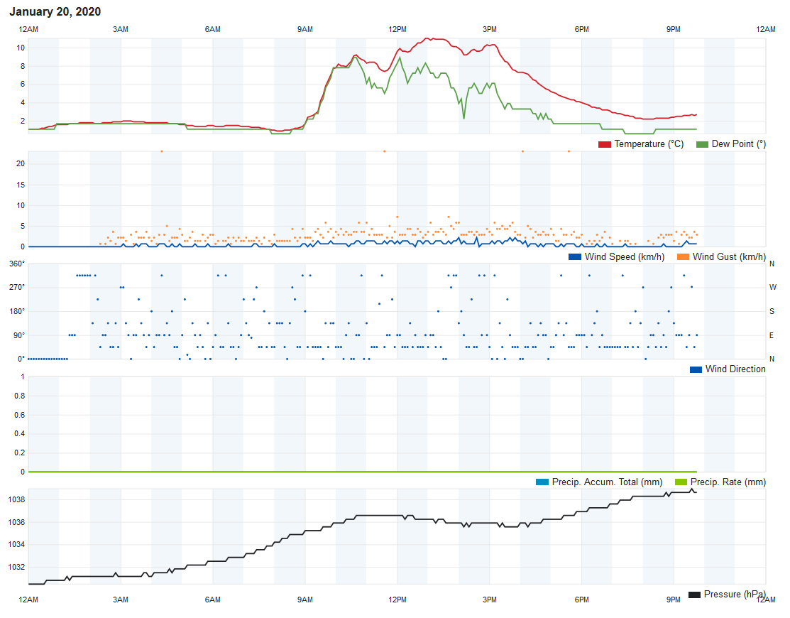

Hello, I did what you suggested replacing the Wireless_Sensors.ino file you sent , but it seem doesn’t solve the problem . I tried using a POWERBANK as power source just to be sure it doesn’t get any interference from the power line. As you can see on pics attached below, you can see that the temperature freeze when reach 0.1 degrees ( 3.00 am ) . Then in the morning I manually did a Reset to restart the system and its refresh all data in the right temperature.
I added a temperature sensor and humidity sensor compensation in the previous update , just in case you want as extra info .

Does the rainfall rate which is shown on the screen of the receiver also changes as happens on your graphs? Do you have any Cumulus graphs where the Rainfall Rate shows the same behaviour?
