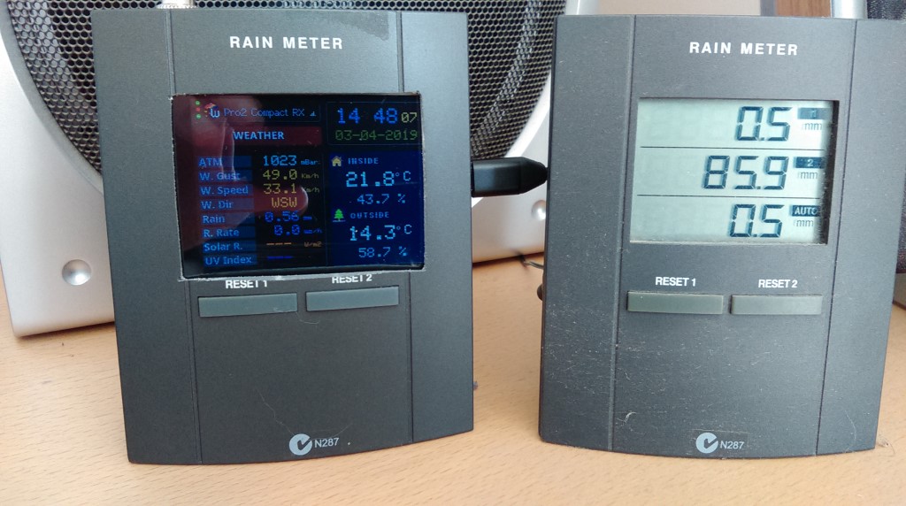

I decided to re-use an old rain gauge display case.
The one on the right is an original. The 2.8 display is a tight fit.
Previously, I had a 2.4 inch display in the case and it was a much easier task.
