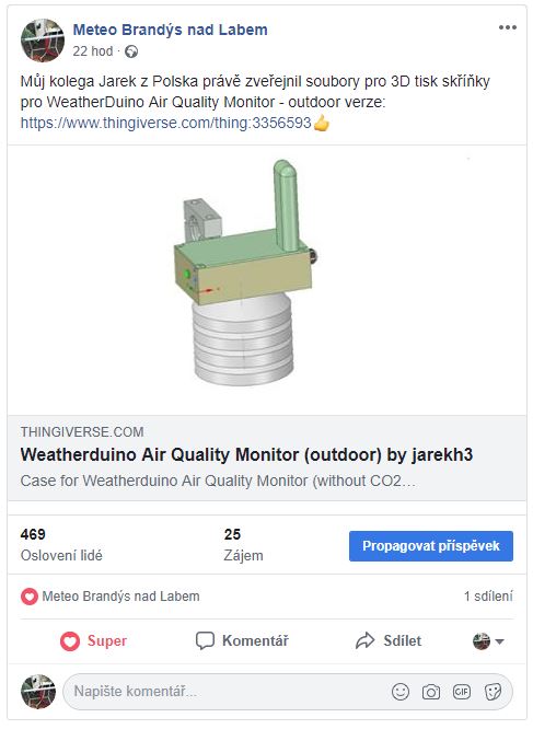

This is cutting from my Facebook page (that's the last 22 hours):
(People like it ...  Smile
#24
(15-01-2019, 22:52)hornychz Wrote:  This is cutting from my Facebook page (that's the last 22 hours):
Big Grin
