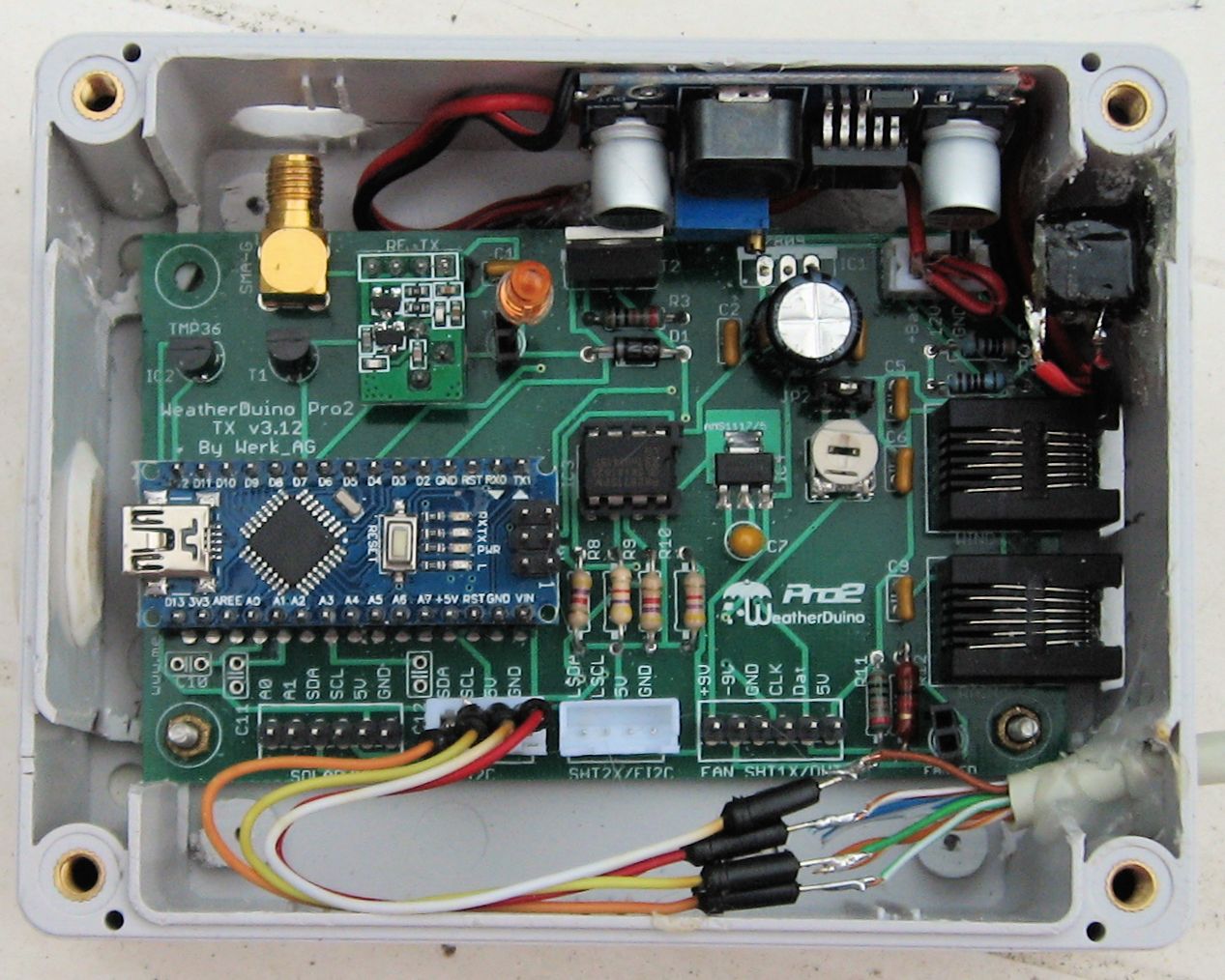

I have finished my Weatherduino Pro2Plus build.
And its working.

I have attached 2 pictures of the station.

I'd be looking at insulating those Temp sensor leads though (or get the female connector).

I was concerned that the sensor (sht21)would not work on my cable, which is just over 2 mtrs long.
In fact it works fine.
So it is a very temporary hook-up.
My next step is to make some sort of shield for it and tidy up the wiring.
Best Regards Derek.
(12-06-2017, 12:10)Derek Wrote:  I was concerned that the sensor (sht21)would not work on my cable, which is just over 2 mtrs long.
As you have the I2C extender chip installed, you can also connect your sht21 to the connector on the right to where you have it now. This will allow you to use even a big cable if needed.  Idea

I wired up my SHT31 to a 2m/6ft CAT5E cable plugged into the EI2C port just to see if it would work, and so far it seems to be operating OK.
