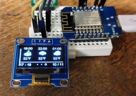

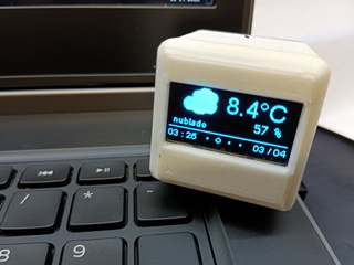

This is a so simple project that just a few words are enough to describe it. Can be built and used by anyone, no matter have or not an WeatherDuino weather station.
No PCB required, all you need is a Wemos D1 Mini, a 1.3" OLED display, and four wires, and of course the firmware*, which you will find on the bottom of this topic.

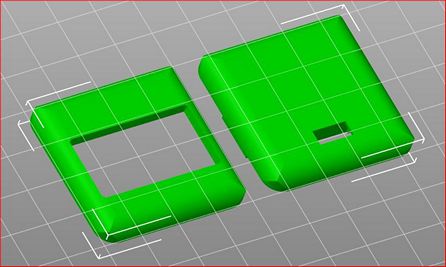

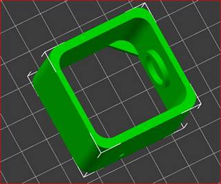

We are also providing the STL files for 3D print the small box where all the parts will fit inside. No screws needed.
* The Weather Cube firmware use libraries and some code of the original work ThingPulse esp8266 weather station from Daniel Eichhorn.
[attachment=3069][attachment=3070]
What does the Weather Cube do?

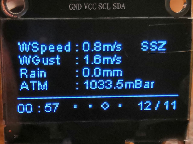

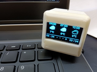

It fetch current weather conditions plus a forecast for the next nine hours from OpenWeather.
For WeatherDuino users, besides the data fetched from OpenWeather, there is also the possibility to display some local data from your own weather station.

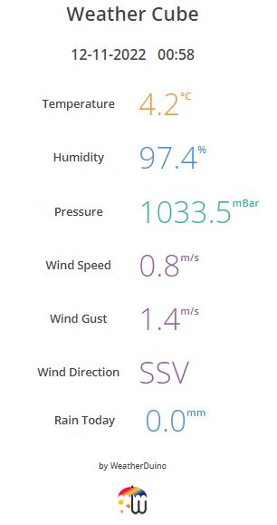

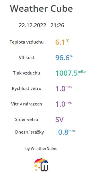

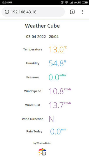

Additionally you can point any browser from a phone or PC to device IP Address and get a quick view of the current most relevant data.

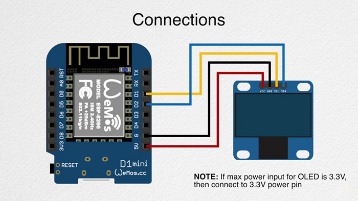

How to make the connections?
Easier is difficult.
[attachment=3071]

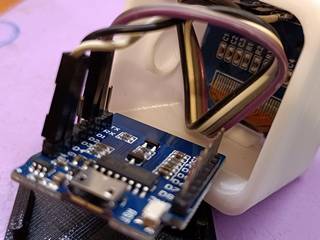

How to assemble?
Once you have the little box, everything nicely will fit in place. No screws needed.
[attachment=3072]
How to have the small box?
Print it yourself or request it from an online 3D printing service.
You will find the required STL files on the bottom of this topic.
[attachment=3075][attachment=3074]

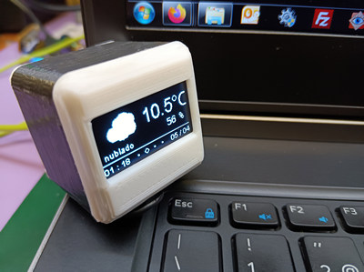

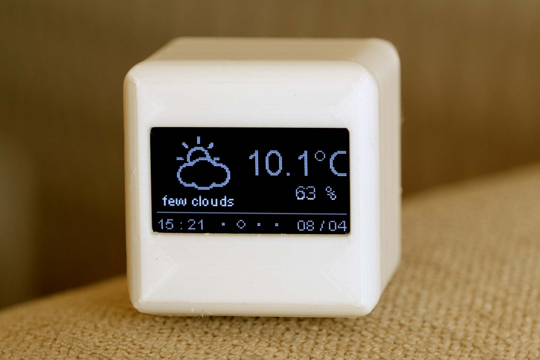

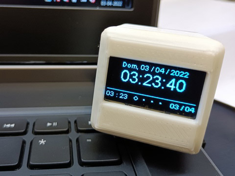

Here is another one... this time with a white OLED display, think it goes better.
[attachment=3082]
(05-04-2022, 01:29)Werk_AG Wrote: [ -> ]Thanks my friends.
Like
Cool

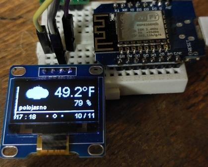

Made one Today Big Grin
Just a question, how do you change the wind speed to mph?
Also I had to change O (Oeste?) to W (West) in the Config Options. (const char* vaneDirectionsText)
[attachment=3084]
