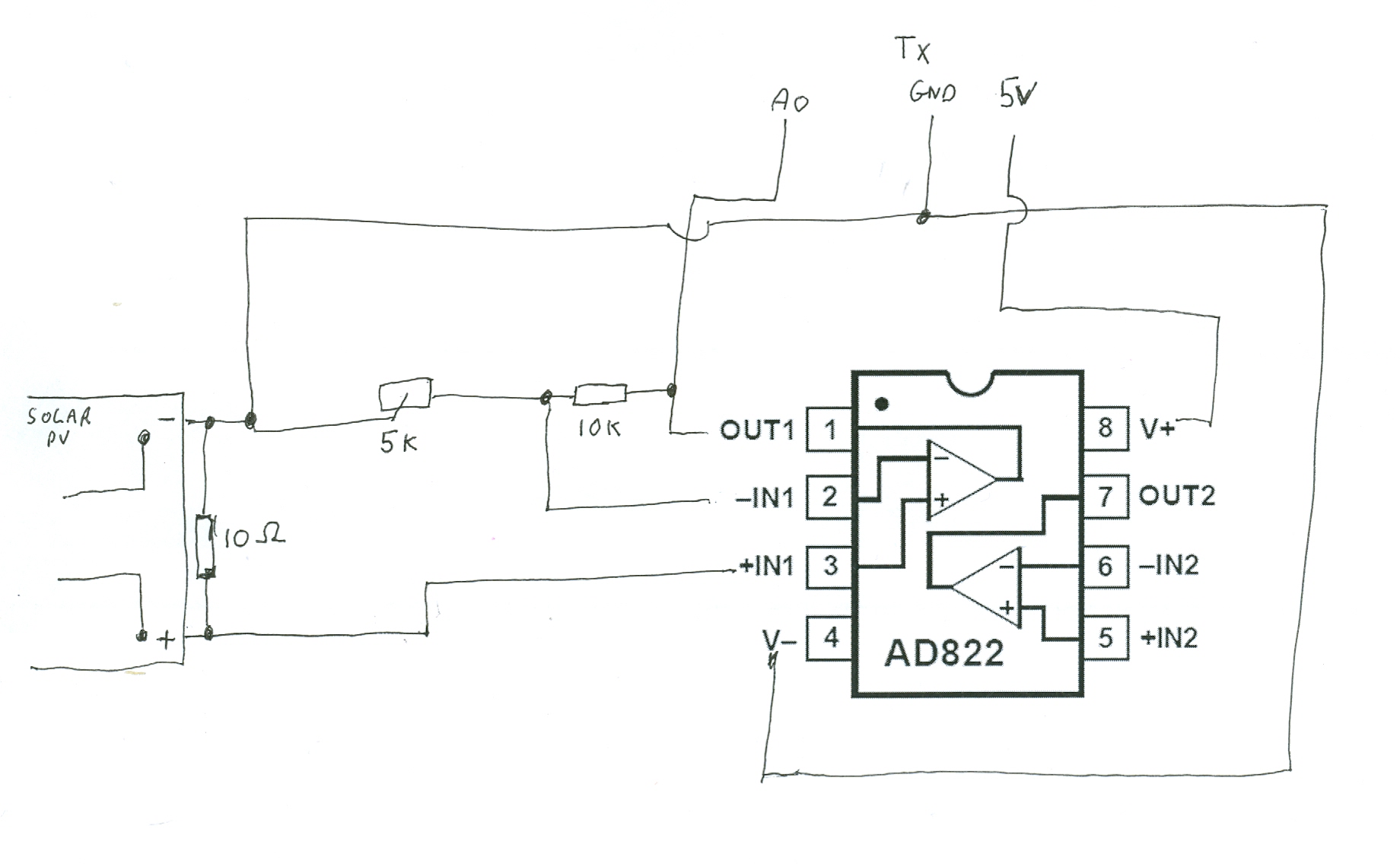

(12-07-2015, 15:19)AllyCat Wrote:  Hi,
Looks OK, provided that you (have) put the "Short-Circuit Load Resisitor" (typically a few ohms) directly across the PV Panel terminals. And of course connected Power and Ground to the Op-Amp pins. Smile
Cheers, Alan.
OK thanks; 10 ohm or less for "Short-Circuit Load Resistor"; Pin 4 to TX ground and Pin 8 to TX 5V?
