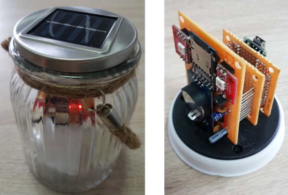

Thanks for your help peps!! This forum made it possible for me to build my pv-cell pyranometer based on an ALDI garden light (attached) with a friend of mine! It will be used to validate machine learning GHI predictions of my master thesis in rural Kenya to improve the efficiency of rural electrification  Music .
It logs the data on a micro SD card to be independent of potentially lacking IT infrastructure and is powered by a battery to be independent of missing power supply. The best feature is probably the fancy cord handle, hence its potentially the most haute couture pyranometer ever build  Cool .
