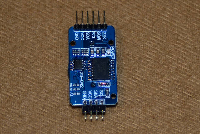

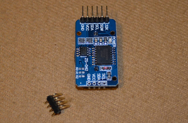

Take a 4 pin right angle connector.
Insert it, with the long pins in the RTC module as show in picture below.
Solder and cut pins in excess.

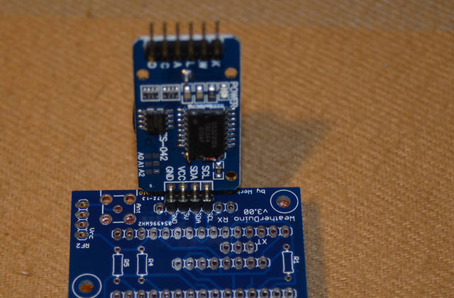

Insert the RTC module in the RX board as show in picture below.
Only solder the RTC module after all other parts are assembled.
![[Image: RTC_assembly_01.jpg]](http://www.meteocercal.info/forum/images/01forum_img/RTC_assembly_01.jpg)
