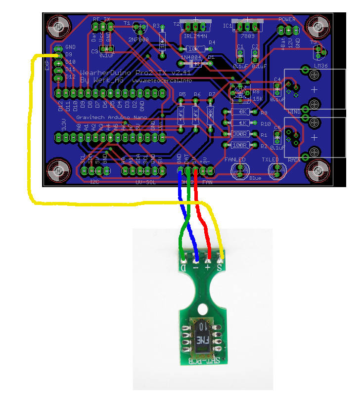

Support for Sensirion SHT1x sensors, was introduced on the WeatherDuino Pro2 TX software after the TX boards v2.40 and v2.41 have been drawn. For this reason there is not a dedicated connector to this sensor, however it is very easy to connect it, you can use the same connector used for the DHT22 sensor, adding a single extra link.
The image bellow illustrates how to proceed.
On the WeatherDuino Pro2 TX software just change this line
to this
Easy, or not?
#define ID1 1 // 0 for SHT1x, 1 for DHT22to this
#define ID1 0 // 0 for SHT1x, 1 for DHT22Easy, or not?
Connecting a SHT1X sensor to WeatherDuino Pro2 TX board v2.4x
![[Image: WDPro2_SHT1X.jpg]](http://www.meteocercal.info/forum/images/01forum_img/WDPro2_SHT1X.jpg)

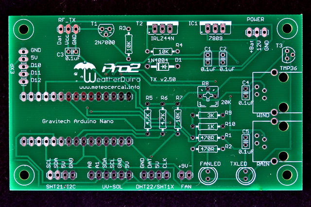

![[Image: WDPro2_TXv250.jpg]](http://www.meteocercal.info/forum/images/01forum_img/WDPro2_TXv250.jpg)
