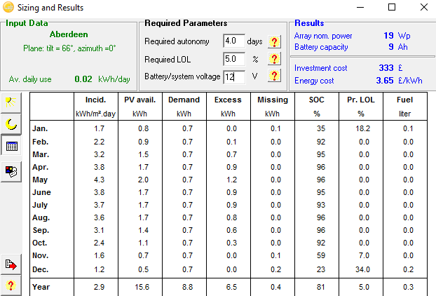

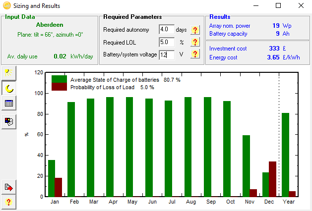

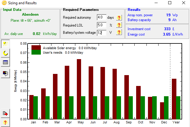

For a permanent 1w consumption with an optimal winter tilt of 66% (facing South) and assuming an unobstructed horizon with a 5% chance of Loss of Load (the system failing) using weather data from Aberdeen (SOC under 50% will stress/wear the battery in Dec.-Jan. Also there is a 1/3 likelihood of system failure in Dec. - see table in third pic.):

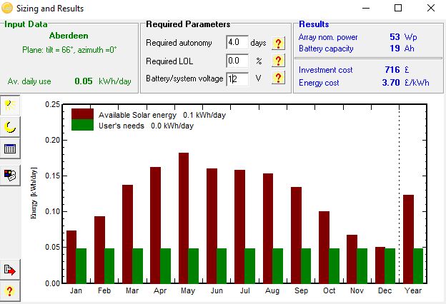

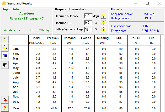

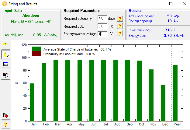

For a permanent 2w consumption with an optimal winter tilt of 66% (facing South) and assuming an unobstructed horizon with a 0% chance of Loss of Load (the system failing) using weather data from Aberdeen:
Personally, I would go for nothing less than the second option. At least a ~50W panel and a ~20Ah battery.

(03-06-2016, 09:53)hvalentim Wrote:  For a permanent 1w consumption with an optimal winter tilt of 66% (facing South) and assuming an unobstructed horizon with a 5% chance of Loss of Load (the system failing) using weather data from Aberdeen (SOC under 50% will stress/wear the battery in Dec.-Jan. Also there is a 1/3 likelihood of system failure in Dec. - see table in third pic.):

Thanks for providing that information, I think I'll aim for at least what you've suggested. December and January were the months I was most concerned about. I may even opt for a larger battery than 20ah.
