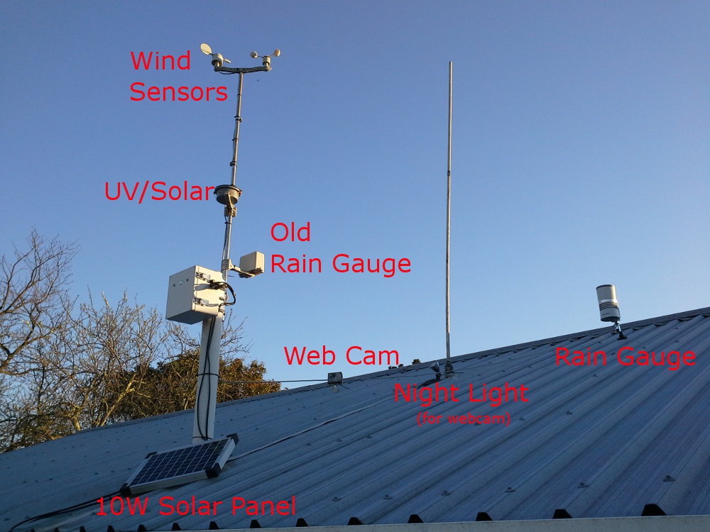

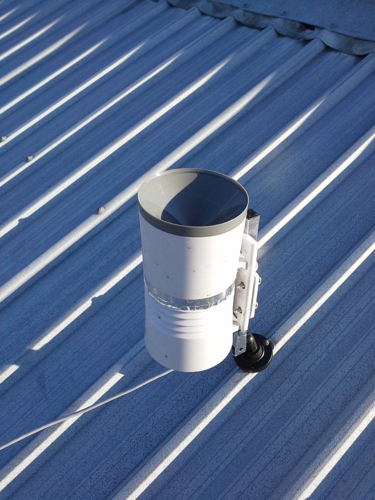

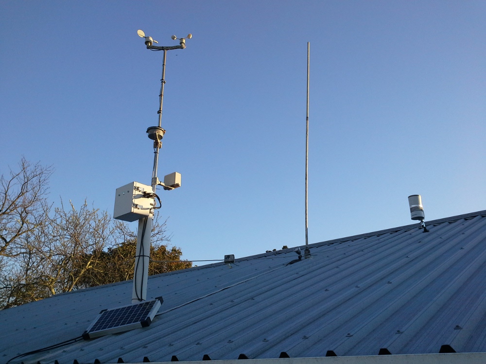

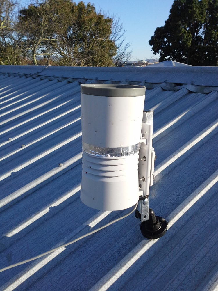

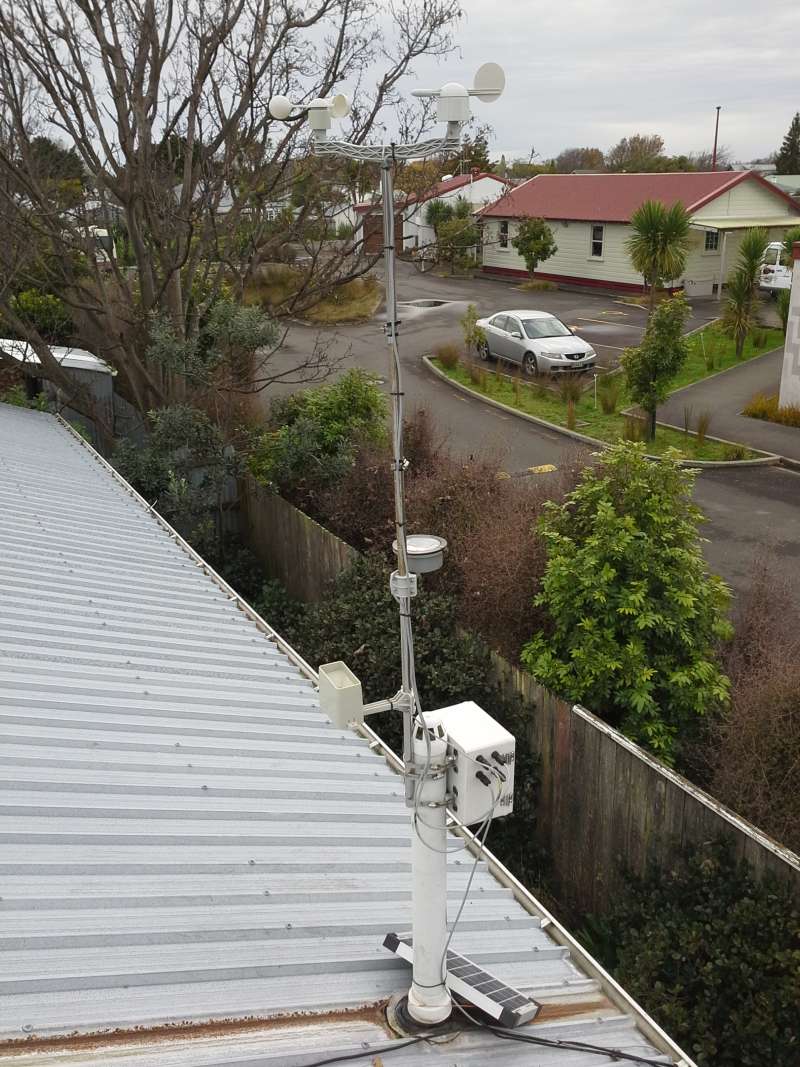

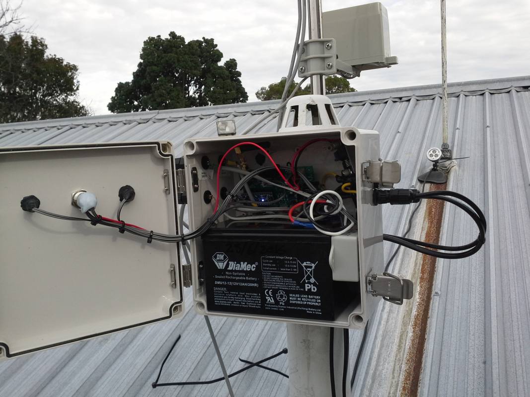

I have made another change to my weather station. I have upgraded the rain gauge to something that is more accurate than what the original "Fine Offset" gauge offered.
This rain gauge has a much deeper catchment, preventing splash out. It is also round rather than rectangular making catchment even, no matter what way the weather is coming from.
Mounting has also been an issue until now. With the rain gauge mounted on the main anemometer mast, false rain readings would be recorded due to vibration of the mast or wind blowing beneath the rain gauge.
The new positioning of the rain gauge will see this greatly reduced. Wind will not be able to cause false tips and with the firm mount on the roof, vibration is also eliminated. It is also in a much more open and clear position; I know that a roof top rain gauge is not idea, but due to my location, this actually provides the most open space. The lip of the rain gauge is in line with the pitch of the roof.
Why is the rain gauge such an odd shape with vents? Well it is part of a stand-alone wireless rain gauge with built in temperature sensor. Sadly it does not follow the "Auriol" wireless protocol so it has been modified to work on a cable. No additional calibration required as this unit also holds the 0.3mm of rain like the "Fine Offset" gauge did.
#22
Very nice installation!
Have you noticed any difference in the readings between the FO rain gauge and the new one?
#23
On the last day it rained, it was bang on with the local airport readings which was great to see. Usually there can be a little bit of variation, but I guess you would expect that anyway as they read a few kilometres north of my location. I will keep you posted as time goes along.

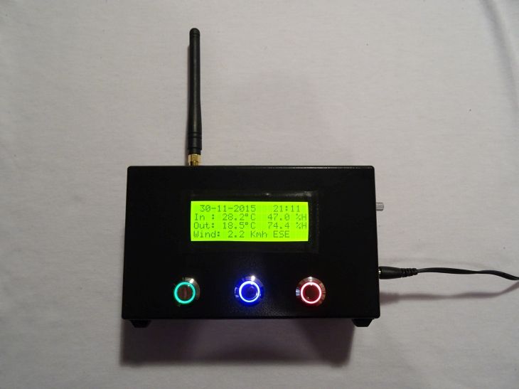

(09-12-2015, 08:51)Palmyweather Wrote:  Just in case people are interested, I have attached a video of the receiver at work with a bit of a text explanation which might give some people ideas for their own system.
As you can see from the video, I have changed the way the LCD screen displays the information. I have the temperature at the top of the screen which cycles between indoor and outdoor.
In the middle, I have the wind speed and direction which displays the wind gust information rather than the average wind speed. This maximises the frequency of updates from the outside unit (every 5 seconds); one of the most frequent updated pieces of information this station has.
The last line cycles through the barometric pressure, rain fall, solar radiation and UV index reading. This is information which, although important, changes slower/less frequently than other aspects and therefore a slower cycle time between data being displayed can be afforded.
I am very happy with how this shows the information for what I require but I understand that this might now be what everyone is after. That is the benefit of this system, it is fully customisable to your needs.
I think your configuration of the LED information is probably the most logical. Is it possible you could explain the changes to the software to me
As you said the wind is one of the most variable pieces of info and the barometric pressure, rain etc the least likely to change at any pace.
