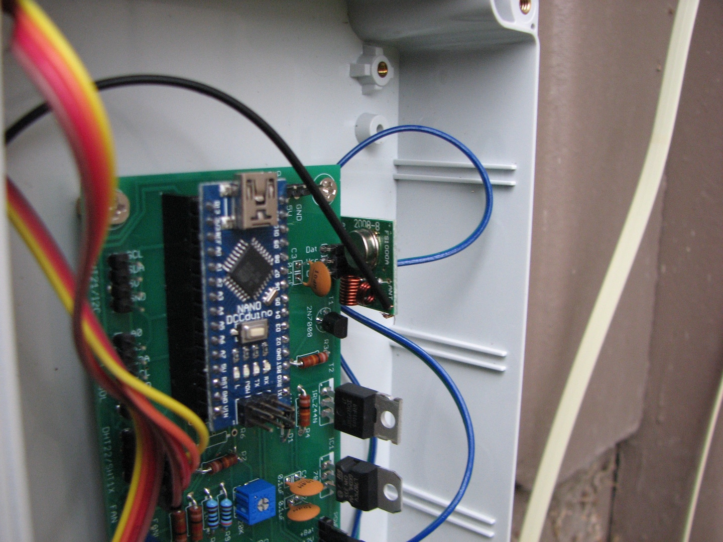

Today I checked the connections on the 7809 regulator. There was 12V input and 8.94V output. Most of the 5V connections on the board showed 5.01V.
Another thing that I noticed whilst testing the Rx board, was that if the board only had the USB connection or the power connection plugged in, not both, then the Rx unit seemed to be receiving the data from the Tx unit. When both the USB and power connection were plugged in, the Rx seemed to lose connection with the Tx unit.
I thought maybe some of the solder connections to the Nano were maybe a little light on solder, so re-soldered all of the Nano connections. After that I restarted the Rx board and it seemed to work perfectly for about 20 minutes with both the USB and power connections plugged in. After the 20 minutes, the Rx board stopped responding again, both as far as the Tx LED flashing and connection to Cumulus goes. I ended up removing the power connection, restarting Cumulus and everything went back to working on the USB connection.

Just wondering, was the Arduino Nano soldered directly onto the circuit board, or was an IC holder used first with the Arduino Nano mounted afterwards?
If soldered directly onto the circuit board, could excess heat maybe have damaged some of the sensitive components on the Arduino Nano resulting in this kind of issue? Especially with this explanation below:

I made up a socket connection for the Nano, using female header connectors and have always removed the Nano when soldering/re-soldering.
Today I bought a shielded USB cable that advertises that it protects against potential electromagnetic interference, but that made no difference to the problem. After connecting up a USB mains adapter/charger, the Rx board appeared to start working properly. However, after about 5min I swapped the USB cable back into the PC and it continued to work, so I don't really know whether that actually proves anything. Huh
I'm starting to wonder whether the DCCduino Nano (cheap clone) on the Rx board may be faulty. Maybe it could be faulty around the switching circuitry that Werk_AG outlined. I am just in the process of purchasing a genuine Arduino Nano, to see if that will make a difference.

Regarding this concern: Sometimes I mount the nano with sockets, others I solder it directly on the board, but when I choose to solder it on the board, I use the full pin length, to keep it raised relatively to the RX board, this allows a better air flow (the nano voltage regulator is assembled in the underside of the Nano board)
