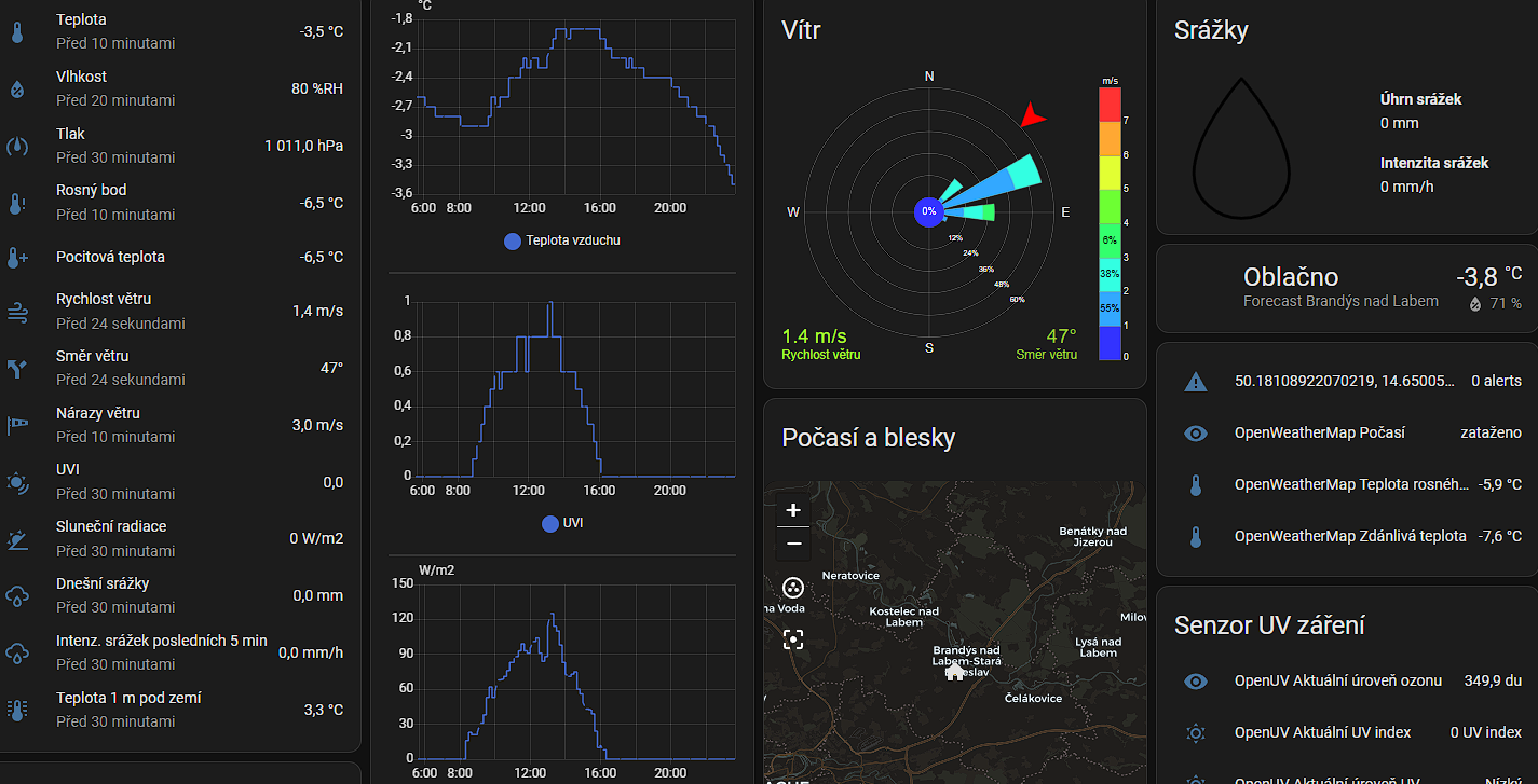

I’ve released a custom Home Assistant integration for WeatherDuino that reads sensor data locally via HTTP JSON – no cloud, no YAML configuration required.
🔧 Key Features
  • Local integration via JSON endpoint (/ json )
  • Config Flow (UI setup) – just enter IP/hostname
  • Automatic sensor creation
  • Clean naming (no “WeatherDuino + IP” prefixes)
  • Supports a wide range of sensors, including:
    • Temperature & humidity (indoor / outdoor)
    • Barometric pressure
    • Wind (speed, gust, direction)
    • Rain (rate & total today)
    • Solar radiation / UV
    • Air quality (CO₂, PM2.5, PM10, AQI)
    • Soil moisture & additional external sensors
📊 Included Dashboard Examples
  • Windrose Card (24h / 4h wind distribution)
  • ApexCharts (wind, gusts, rain history)
  • Rain Gauge Card
  • Mushroom Cards for quick status & values
    All Lovelace YAML examples are documented in the repository.
