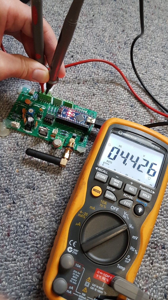

Measuring the voltage across the data pin to ground gives 4.4VDC reading.

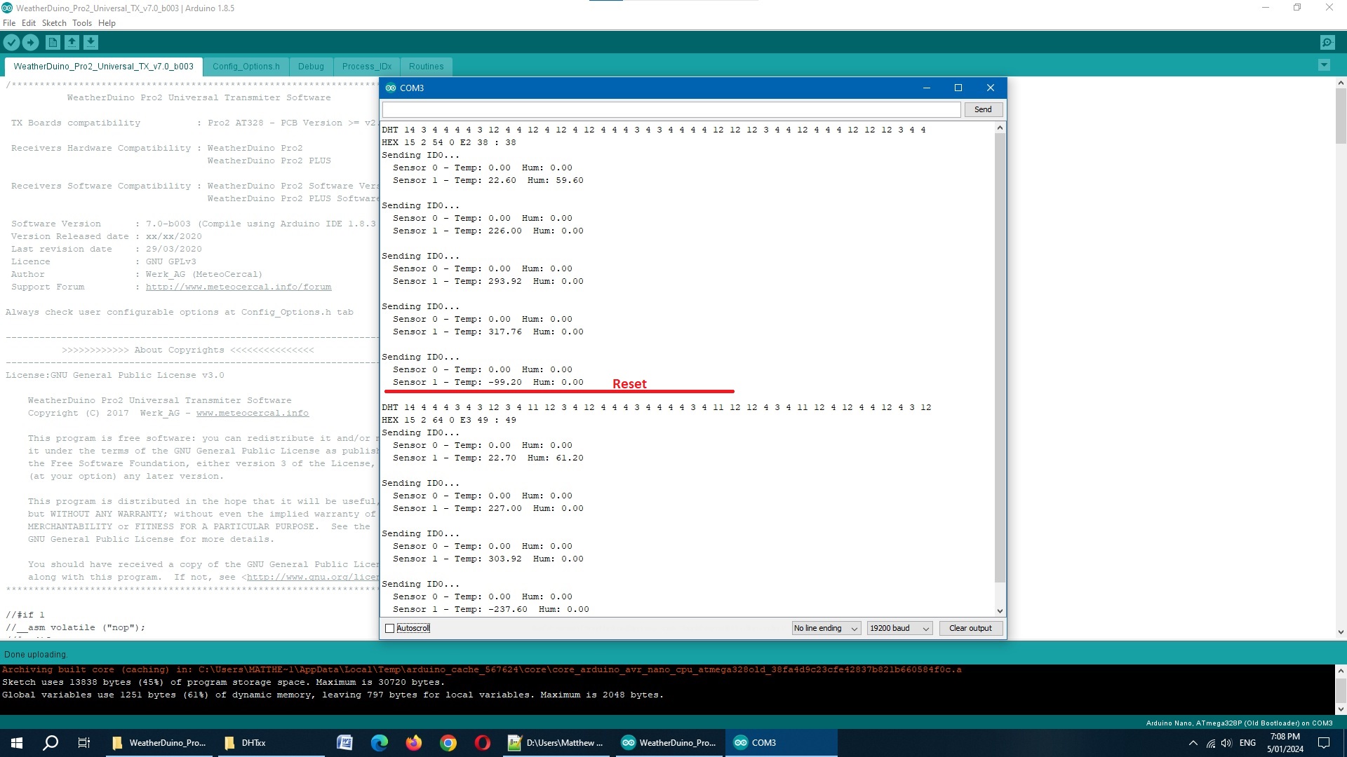

I have enabled the serial data output from the DHTxx library with the below results. I note that the serial data from the DHTxx library only displays once on the initial reading and not again.
DHT 14 3 4 4 4 4 3 12 4 4 12 4 12 4 12 4 4 4 3 4 3 4 4 4 4 12 12 12 3 4 4 12 4 4 4 12 12 12 3 4 4
HEX 15 2 54 0 E2 38 : 38
Sending ID0...
  Sensor 0 - Temp: 0.00  Hum: 0.00
  Sensor 1 - Temp: 22.60  Hum: 59.60
Sending ID0...
  Sensor 1 - Temp: 226.00  Hum: 0.00
Sending ID0...
  Sensor 1 - Temp: 293.92  Hum: 0.00
Sending ID0...
  Sensor 1 - Temp: 317.76  Hum: 0.00
Sending ID0...
  Sensor 1 - Temp: -99.20  Hum: 0.00
After board reset:
DHT 14 4 4 4 3 4 3 12 3 4 11 12 3 4 12 4 4 4 3 4 4 4 4 3 4 11 12 12 4 3 4 11 12 4 12 4 4 12 4 3 12
HEX 15 2 64 0 E3 49 : 49
Sending ID0...
  Sensor 1 - Temp: 22.70  Hum: 61.20
Sending ID0...
  Sensor 1 - Temp: 227.00  Hum: 0.00
Sending ID0...
  Sensor 1 - Temp: 303.92  Hum: 0.00
Sending ID0...
  Sensor 1 - Temp: -237.60  Hum: 0.00
Sending ID0...
  Sensor 1 - Temp: 245.44  Hum: 0.00
So it looks like additional requests for data of the DHT sensor is not occurring.
