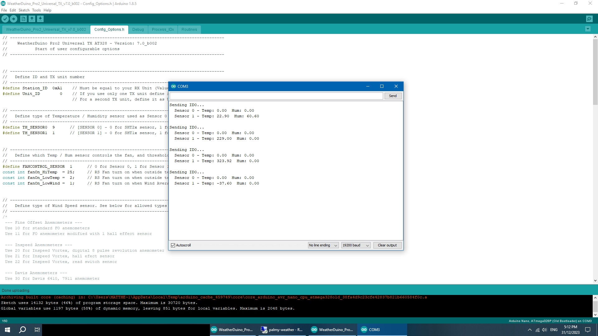

This is becoming quite the mystery.
I have attempted again today to get the DHT22 sensors to work including downloading from this forum the software again and ensuring my libraries match.
I have tried 3 different configuration files over two different TX boards which gives me the same results. These are titled:
  • Main TX board - my main transmitter unit with wind, rain, UV attached.
  • Ground TX board - secondary transmitter with ground and temperature.
  • Test configuration  - This was a fresh copy of the code downloaded once I started having issues in case any other configuration settings were conflicting.
Main TX:

Ground TX:

Freshly downloaded from the forum configuration:
//    WeatherDuino Pro2 Universal TX AT328 - Version: 7.0_b003

Use 21 for Inspeed Vortex, hall efect sensor
Use 22 for Inspeed Vortex, read switch sensor
--- Davis Anemometers ---
Use 30 for Davis 6410, 7911 anemometer
--- Novalynx Anemometers ---
Use 40 for Novalynx, model 200-WS-02F
--- Environmental Measurements Limited ---
Use 50 for EML, model WSD1
--- Didcot Instrument Company ---
Use 60 for DIDCOT, model DWR205
--- Vector Instruments ---
Use 70 for Vector Instruments model A100LK
Use 71 for Vector Instruments model A100L2
Use 72 for Vector Instruments model A100R
#define WINDSPEED_SENSORTYPE 10             // SEE INFO ABOVE!!!
//   Define type of Wind Direction sensor
--- Fine Offset Wind Vane ---
Use 1O for standard FO wind vane
--- Analogue Wind Vanes ---
Use 20 for any 5V analogue wind vane. See bellow for a list of tested models
- Inspeed E-Vane 2
- Davis 6410
- Novalynx, model 200-WS-02F
- Environmental Measurements Limited, model model WSD1
- DIDCOT, model DWD205
- Almost all 5V analogue wind vanes will work
#define WINDDIR_SENSORTYPE  10  // SEE INFO ABOVE!!!
//          Analogue Vane Offset Calibration
const int WDir_offs  = 0;   // Usually there is no need to change default value (zero)
//   Define Rain Gauge tip boucket value (mm)
  Use 0.280 for standard FineOfset rain gauges (Datasheet value = 0.2794)
  Use 0.200 for standard metric Davis rain gauges
  Use 0.254 for standard imperial Davis rain gauges
#define COLLECTOR_TYPE  0.280  // Please note: Values must be in metric units. Max. resolution: 3 decimal digits
//   Define type of UV Sensor
#define UV_SENSOR  9      // 0= UVM-30A, 1= VEML6075, 9= Not used
//   Soil / Leaf Interface Enable Disable
#define SOILLEAF_INTERFACE        0    // 0 = Soil Leaf Interface not used, 1 = Enable Soil Leaf Interface
const byte Number_AnalogSensors = 2;   // Up to 4 analog sensors
//   Define which data this unit will send. 0 = Not send this data, 1= Send this data
#define ID0  1   // Temp/Hum Data
#define ID1  0   // Not Used
#define ID2  1   // Wind data
#define ID3  1   // Rain data
#define ID4  0   // SolRad / UV data
#define ID5  1   // Hardware Status - System Temp, Battery Voltage etc
#define ID7  0   // Send Soil & Leaf Temperature Data
#define ID9  0   // Send Soil & Leaf Moisture / Wetness Data
//   VBat voltage fine tune (values in Volt, positive or negative)
#define VBAT_OFFSET    0.0                  //
//     Hardware Settings
// Define if the TMP36 sensor is instaled
#define USE_TMP36       0          // 0= Not Instaled, 1= Intalled
//   SHT31 I2C Address - Default address will work most of the times!
#define SHT31_ADDRESS 0x44           // Default value is 0x44, but it can be changed to 0x45
//   Debug
#define ENABLE_DEBUG
#define DEBUG_ID0
//#define DEBUG_ID2
//#define DEBUG_ID3
//#define DEBUG_ID4
//#define DEBUG_ID5
//#define DEBUG_SLINTERFACE
//#define EASYWEATHER_TEST
//     End of user configurable options
For reference, I have tested this sensor using TX software build v7.0_b002 on my main board code and existing configuration with the same outcome.
