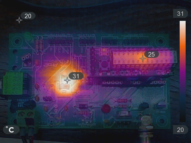

Thermal image Tx board
Just for fun...
Will post some more sometime...
Tx Board...
Shot with the Seek Shot Pro Thermal Imaging Camera
[Image: 20210624-120820-A.jpg]
Interesting image! I would like to have an Thermal Imaging Camera, but they still are a little expensive for me.
Out of curiosity, since I don't see the intermediary 9V regulator, what powering voltage are you using?
(24-06-2021, 19:38)Werk_AG Wrote:  Interesting image! I would like to have an Thermal Imaging Camera, but they still are a little expensive for me.
Well, this is a Tx board what has been abused a bit Wink
I power it with 12V at the moment... I forgot why I removed the 9V regulator... Undecided
Must put on a 9V regulator again...
The board was used to send rain and wind data but this week I separated the two.
I had many problems with strange wind and rain values when it was windy and raining at the same time. So this week I made a arduino Uno shield with another transmitter for Rain data.
Also I had trouble with the chinese Arduino Nano on this board. Maybe it couldn't handle the 2 interrupts simultaneously, hence the strange values??  This week I couldn't upload any more so as you can see I used a normal Arduino Uno with a genuine Atmega chip.
(24-06-2021, 20:28)edr1924 Wrote:  Well, this is a Tx board what has been abused a bit Wink
Smile I suspect of it, the temperature on the 3.3V regulator will lower a bit with the 9V regulator
(24-06-2021, 20:28)edr1924 Wrote:  The board was used to send rain and wind data but this week I separated the two.
Whatever the issue, don't think the problem is handle the 2 interrupts simultaneously. Long time ago I experienced a similar issue, but just with the wind, found out that it was caused by a very long cable between the anemometer and the TX unit.
