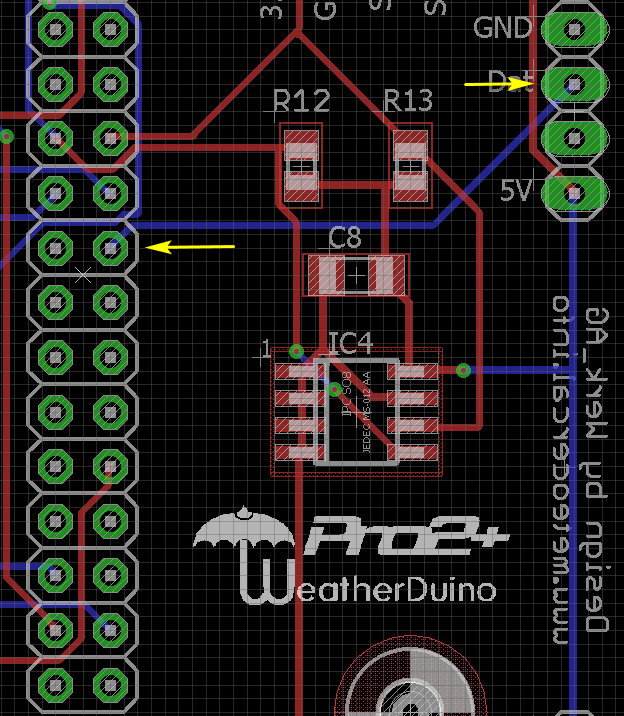

Before replacing the module, you may also check if there is continuity between the two points marked on the image with an arrow.
