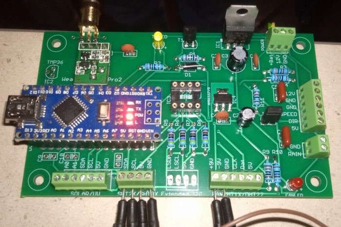

Hi Graham,
It isn't properly a high quality photo, but here is a picture of the new TX v3.13 taken from a unit I use for testing receivers.
Thank you both for adding photos of populated boards. This should help a lot.

Hi Werk,
 l notice on the latest board you no longer use the RJ connectors for the wind / rain instruments,is there a reason for this?
PS
I note that the parts list for the 3.13 refers to the RJ Connectors and
still says they are included
(19-06-2019, 21:49)Barrow4491 Wrote:  Hi Werk,
Hello Jim,
The reason why RJ connectors have been changed to screw connectors on the TX v3.13 board, is because it makes connections easier for those (which are many) who are using anemometers from other brands (Davis, Inspeed, etc) than the FineOfset ones.
For those who wants to use the FO anemometers, connection is also simple, they just need to cut the RJ connector, and connect the wires on the screw connector. There are labels on the pcb to help with the wirings.
(19-06-2019, 21:49)Barrow4491 Wrote:  PS
That was a mistake from my side. Thanks for having spotting it to me. I already corrected the parts list.
