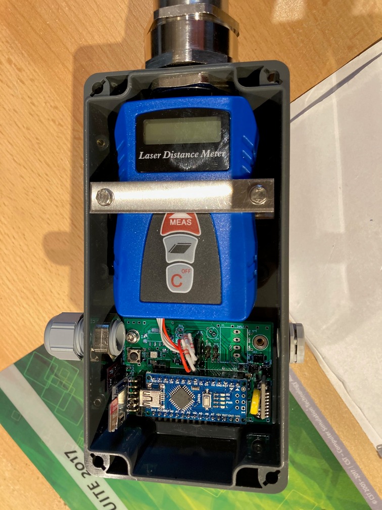

  • HOLO Laser ranging device
    (can be bought as bundle including the PCB)
[Image: y4mub-voTG0uPuU4vyMWwdcbwhSAUrp8HleqOmDr...pmode=none] [Image: y4myiXVHwn6NQlTnX5vTPZ_0aqN_Keh_fmJSqJyR...pmode=none]

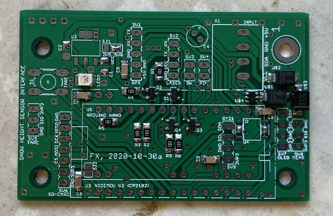

Snow height measurement v4.1 HASL free double layered PCB
Board size: 50mm x 50mm
PCB supplied as pictured below: 13,50€ - Available immediately

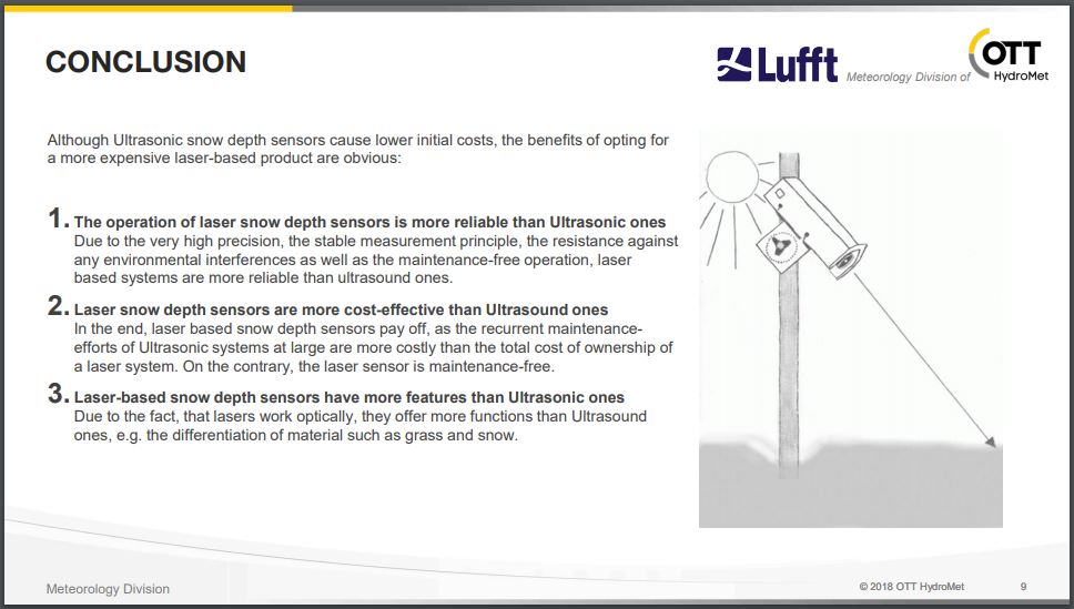

Today I've got a possibilty to download the presentation "Technology Comparison: Snow Depth Detection"
from Luft, Meteorology Division of OTT HydroMet.
URL is https://www.lufft.com/snow-depth-measure...hitepaper/
you can download it after complete the questionnaire.
Manual is only "Insight for Experts", I do not distort the copyright, I only publish their conclusions:
It is clear from this that the method of measurement chosen and developed by engolling is the correct one.  Heart
