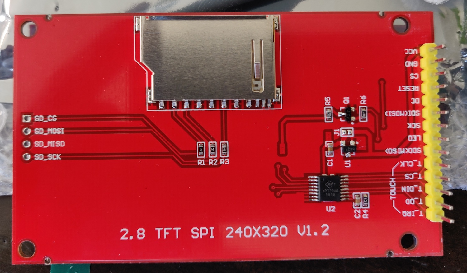

Just checking if this all worked out and these displays are now supported? I purchased 2 from an ebay seller that had everything right in the pictures (version 1.1 and all the exact same writing on the back with black pins) when they arrived today they are version 1.2 with yellow pins  Angry

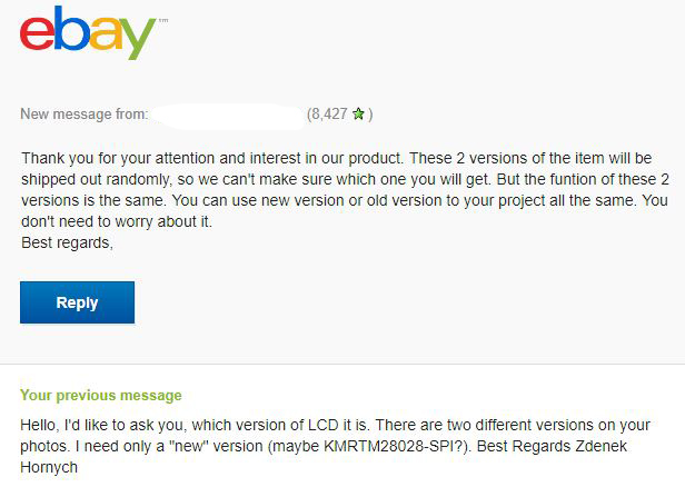

If you bought the TFTs on eBay and the seller sent you an item different from what he shows in the item listing, you can open a dispute asking to return the items. Sellers are obliged to keep product pictures updated. Most probably you will get a refund, because sellers prefer refund than pay the returning costs.

I did some more testing with the yellow header display I pictured above. It has the same XPT2046 touch controller chip as the regular one we use so I plugged it in and it works just fine. The only issue I can find is that the x/y coordinates are different so I press in different parts of the screen to change pages.

#39
Yes, the problem with the clones of the original TFT display, isn't the TFT itself, but the touch panel.
By changing the software you may be able to make it work.
Once the Pro2 Compact is supplied fully assemble including the TFT display,  I haven't included software support for those "yellow" pins displays.
