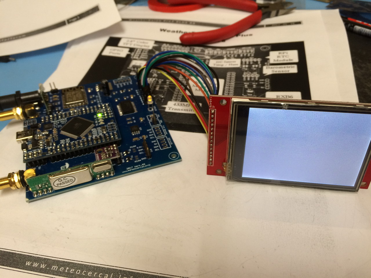

Well, some developments, probably not very positive.
I went over the Rx board and reheated most, if not all of the solder joints, as some looked marginal
No change on reloading the software, so I decided to check voltages, and found that while the 9v and 5v lines were OK, the 3.3v was showing only 1.4v
I took C5 out to check it wasn't short circuiting, and on reconnecting the voltage is now only 0.44v. I've hunted carefully for solder bridges, and no signs.
I presume this means that IC3 is cooked? I had noticed it hot earlier. Is it practicable to replace it? I can get an AMS1117-3.3v for $1,
From the 3.3v line to ground measures about 250 ohms. Does that sound reasonable? It would represent a current of about 130 mA which seems fair.
It certainly doesn't seem there is a major short circuit dragging the voltage down.
The absence (for practical purposes) of 3.3v would explain the wi-fi not starting, and I presume the BME280 and RTC would also fail,and hence the software would not run?
FWIW the 3.3v terminal on the Arduino board produces 3.3V.
Russell

Well, back after life getting in the way a little.
I replaced the AMS1117 and the C5 electro.
Voltage is now 3.32v, but I notice the 3.3v regulator is quite warm after it has been running for a few minutes.
Display, with the "new" TFT is still blank white. The wi-fi is connecting and time is being set from NTP
Where to now, please?
