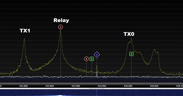

This is what the RF waveform looks like on TX1, TX0, and the relay. For whatever reason TX0 no longer comes to a nice peak like TX1 or the relay. I don't know why they look different as they are supposed to all be the same thing, but they were sourced from different vendors. As you can see TX0 has two peaks and I don't know why that is, whether it makes a difference, or if that is what is causing the problem?
My best suggestion is don't start changing any components, instead, try to adjust the position of receiver and /or TX0 transmitter antennas. Sometimes having them in horizontal position (just one or both) works better than having them in vertical position (thats what happen with me). Do some experiments, leaving the TX1 as it is.

Dan, I'm just trying to help. Believe me, no part has failed. What I'm trying to say, is for you to try to give some privilege on reception from the TX0 unit. Its hard for me to explain technically, but when the frequency of a TX module drifts (and they drift with temperature) from the frequency of another TX unit with a stronger signal, the RX module tends to not receive the weaker signal.
Try playing with the position of the RX and TX0 antennas, until you get a good reception from both TX0 and TX1

That's exactly why I swapped the transmitter module because it was right on top of each other.
I installed a header this time instead of soldering it directly to the board. I changed out the TX module again and now it seems to be receiving TX0 reliably again, but it has only been an hour or two so I don't want to say it is fixed yet. Hopefully this module doesn't drift that far down in frequency.
