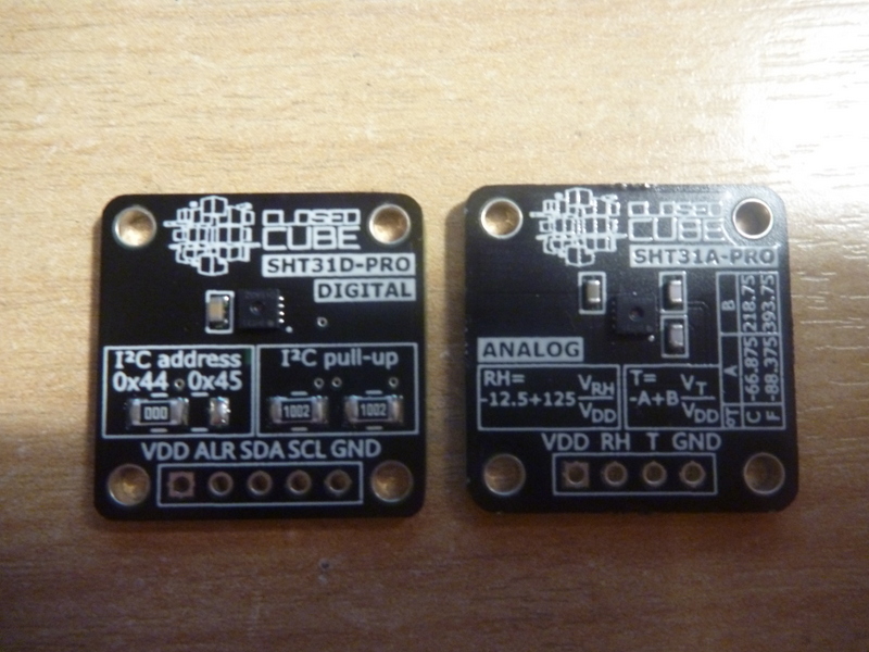

Hooked up the digital "Closed Cube" SHT31 in picture onto the same I2C on TX0 as the SHT21 used to be on.
Did appropriate changes on software.
Started up and RX unit refused to read any Temp data.
Changed back to SHT21, changed software settings back and it began to work immediately.
Wired up VCC to VDD? etc, left ALR not connected. Perhaps this version does not work on Weatherduino, or have I done something else wrong?
Ordered these from China;
http://www.ebay.co.uk/itm/New-SHT31-SHT3...SwiDFYPocC
See if that works, anyone else got the "Closed Cube" Version to work?
#14
I don't see any reason for those modules do not work.
The TX board have two I2C connectors, have you tried on both?
#15
(26-06-2017, 20:20)Werk_AG Wrote:  I don't see any reason for those modules do not work.
I shall try this next weekend when  I get onto the roof. See what happens, perhaps I just have a faulty module.
#16
(26-06-2017, 10:26)JT118 Wrote:  Hooked up the digital "Closed Cube" SHT31 in picture onto the same I2C on TX0 as the SHT21 used to be on.
I have had one working for about 11 months in my Tx without any issues. I bought it on ebay direct from Closed Cube in England
#17
I'm using this SHT31 board from closed cube. Purchased from tindie.
https://www.tindie.com/products/closedcu...re-sensor/
#18
(27-06-2017, 07:22)danner Wrote:  I'm using this SHT31 board from closed cube. Purchased from tindie.
I'm using the same sensor.
#19
It's working now!
