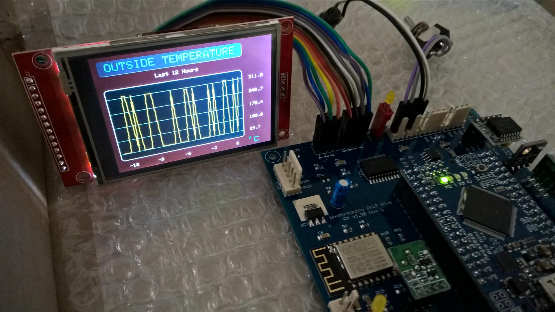

Looks like I may have an issue to investigate..???
Have been testing a new weather station which has just been built over the past couple of weeks and will eventually be heading to a mate in Sydney for installation on his house.  With the new 433Mhz modules now installed, the RF link looks solid.  Currently have the 3.12 TX in the storeroom with a DHT22 attached to feed in some data.  The Pro2+ RX station is sitting in the Kitchen, about 10m away.
The main screen looks good and getting constant temp readings and no issues and no "---" readings.  I'm getting about 84% efficiency on the RF link.  All debug code is turned off and/or rem'ed out at the moment.

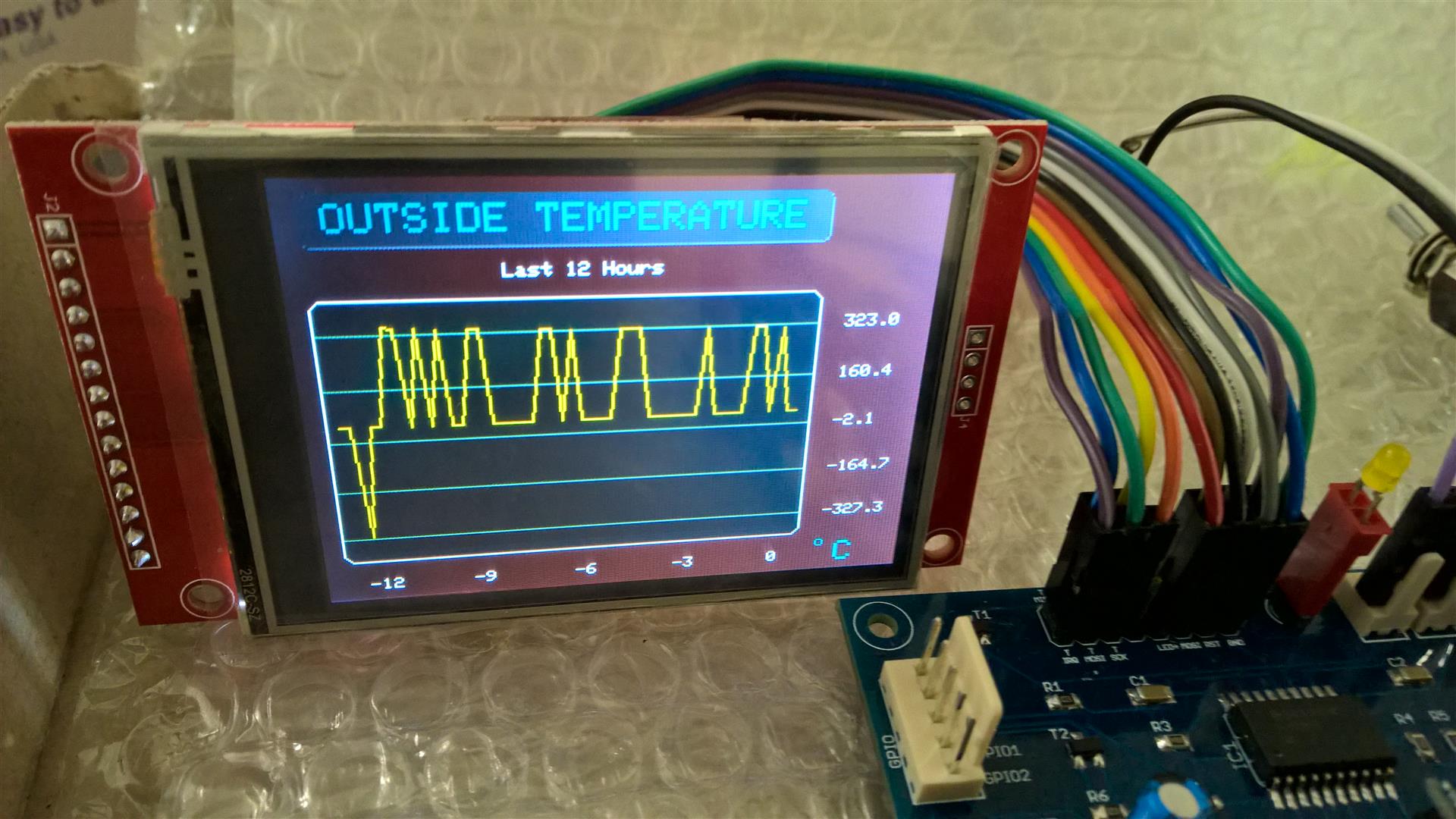

When I hit the double-press on the button and change to the graphs, and then swipe over to the temp graph, I am seeing the above readings.  Interesting observation is that the erroneous peaks seem to be just about a perfect multiple of 10, to the current actual readings..???
I'll start looking at the issue tonight.   Any one got any thoughts out there that may assist..???

I have confirmed that the TX is set to DHT22 sensor. Note that this is "testing" only and the sensor is brand new and locate inside. It's not located out in the weather. The version of the TX code is 2.0-b015 13/1/17.
I'm just back in from lunch, and walked past the receiver just before and noticed something interesting, and probably not surprising. I noticed that the outside temp on the home screen was showing as 305 degrees, and then just a few seconds later the screen refreshed and it showed as 30.5 degrees.
Humidity readings in the graph look normal and are not having spikes or erroneous readings. Normal and not multiplied by 10 or any other value.

Update - have upgraded to latest code and reloaded both the TX and the Pro2+. Still seeing the same erroneous readings on the temp graph... Sad
Will have to think up a plan of action, and keep looking into the issue...
