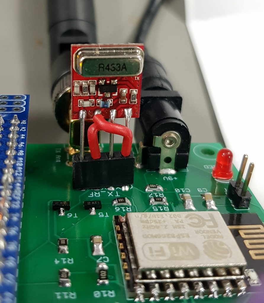

RE: WD wont recieve - atbukc - 18-03-2019
Photo of the transmitter here..
i couldn't find any TX modules with the correct pinout, but this one seem to work very well...
If anyone has a UK source of TX modules with the correct pinout I'd be interested..
Andy
RE: WD wont recieve - hornychz - 18-03-2019
(18-03-2019, 18:01)atbukc Wrote:  Photo of the transmitter here..
Andy
Hello, Andy,
I think, it should be "KXD-10036 RF Transmitter Module 433 MHz", you can read about it in the thread
https://www.meteocercal.info/forum/Thread-Where-to-buy-the-433MHz-Modules
Maybe everybody of us usually buying it in China - for example at eBay.  Smile
