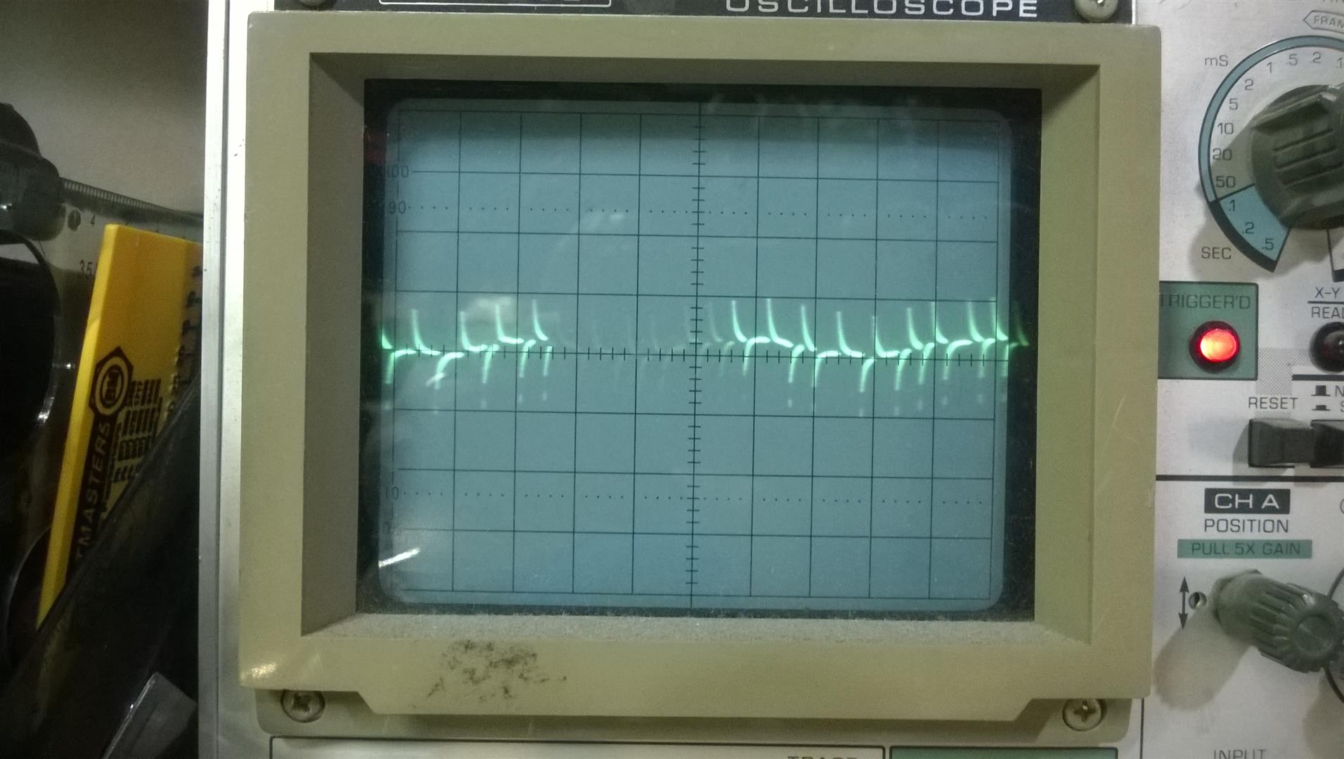

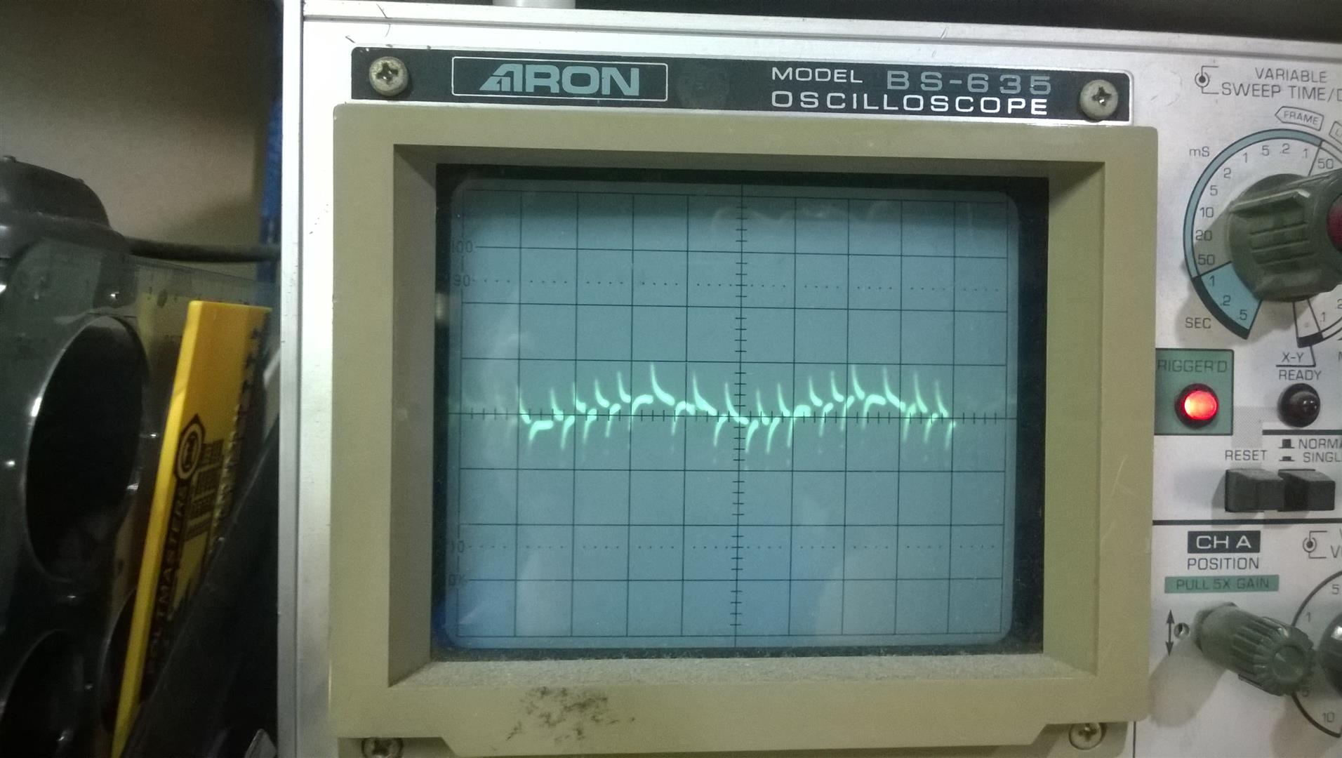

I connected a CRO to the Antenna Output on the TX (sensor sender) unit, and captured a signal with the camera on my phone (not a capture cro Sad ). I then connected the CRO to the Antenna output on the TX module of the RX unit, and captured similar signal.
Not sure how to attached photos to this post, in this forum..???? Is it possible somehow..???
So, on the surface, it looks like the TX module on my WeatherDuino RX unit working and sending a signal out, to the WirelessDisplay.
I'm using those little 80mm 433Mhz antennas, from eBay, that have the right-angle bend just after the connector.
Ok, I worked out how to add attachedments, via the "full" editor option. Have attached the two captures from the CRO. These were captured at 20mV per division @ 5mS sweep.
The TX unit is workig ok, and the signals look similar, so I presume my TX module on the RX unit is functioning ok and sending a signal.

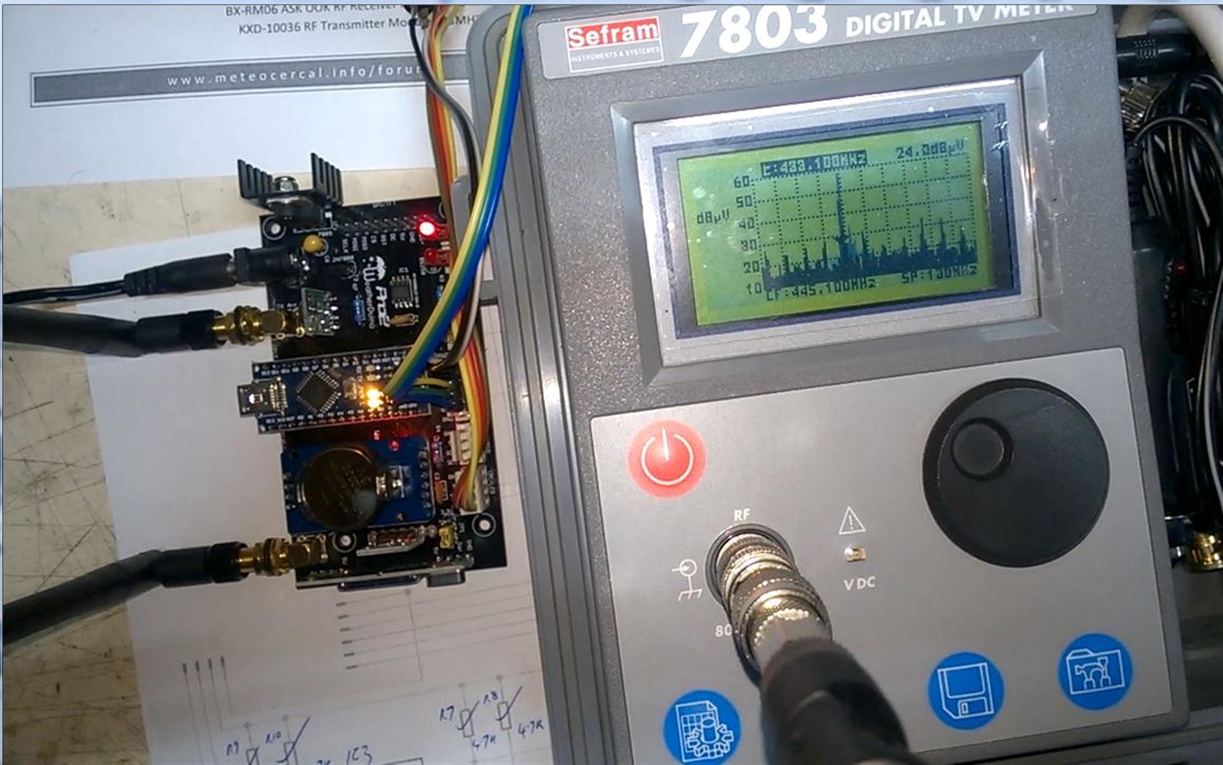

I setup a spectrum analyser with one of those 210mm 433Mhz antennas, and I am seeing a signal output from the RX unit @ about 60-65dB, every time the TX Led blinks, so again I believe the RX unit is transmitting a signal ok. Have attached a photo of the capture.
[attachment=616]
Think I'll turn my attention now to the WirelessDisplay unit.
