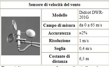

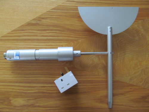

Didcot:
From the mid 1980's to mid 1990's
Very high quality:
Anemometers:
Various configurations, current, voltage and reed switch.
[attachment=301][attachment=302][attachment=303][attachment=304]

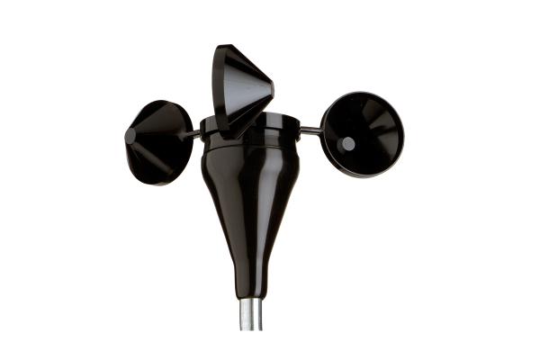

NRG Anemometers:
https://www.renewablenrgsystems.com/prod...anemometer
Many types; Hall effect; voltage output and current output.
Occasionally available at end of wind turbine project surveys
[attachment=305]
