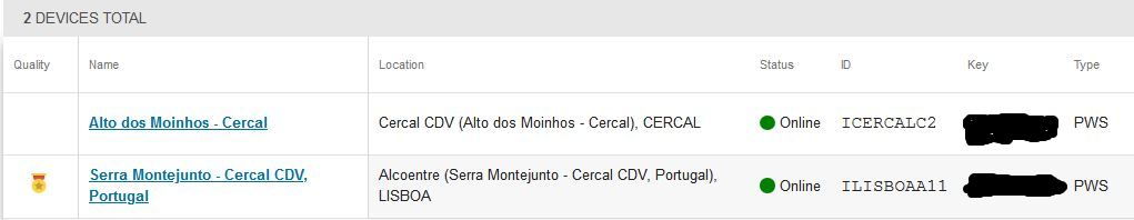

On Credentials.h, instead of your WU password, put your Station key. If you don't know it, log on to your WU account, and see it.
// -------------------------------------------------------------------------------------- // WU Credentials // -------------------------------------------------------------------------------------- const char* WU_STATION_ID = "ILISBOAA11"; // WU Station ID const char* WU_PWD = "XXXXXXXX"; // WU Station Key
[attachment=2422]
