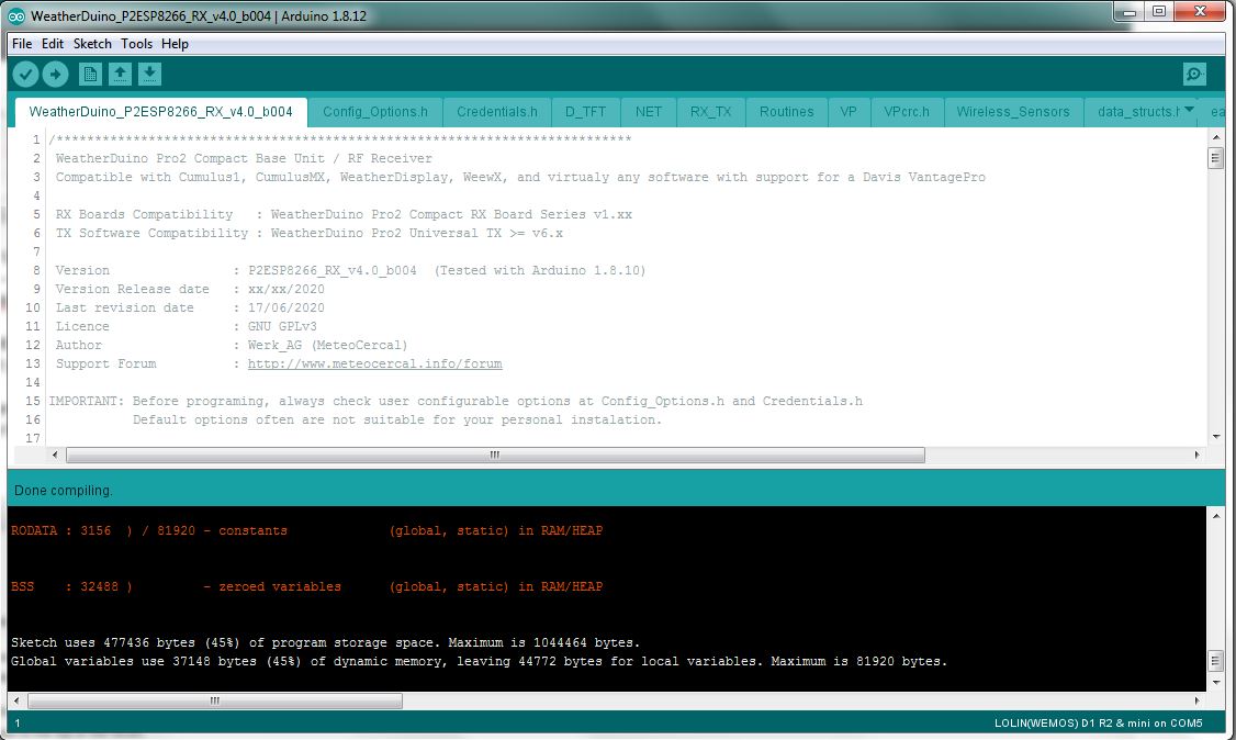

2- Can you please post here a screen copy of your Arduino IDE, after code compilation?
I'm asking for an image like the one below.

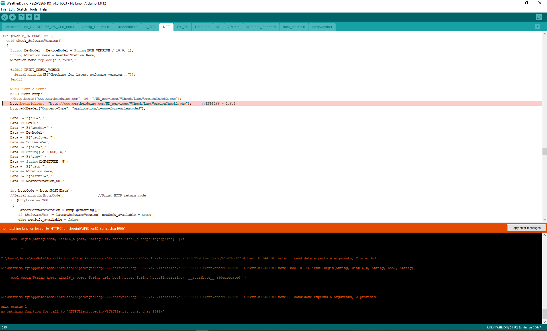

Through the IDE compile, I get the attached error. Nothing comes up on the Serial Monitor after upload with ESP8266 Sketch Data upload.
