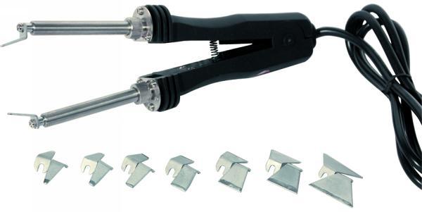

What technique did you end up using?
Where I work there is a little  electronic section, I used a desoldering tweezers because there is no hot air station.
[attachment=1457]
(07-05-2018, 09:32)laulau Wrote: [ -> ]Where I work there is a little  electronic section, I used a desoldering tweezers because there is no hot air station.
That's great, well done! Excellent to hear it is all sorted out.
