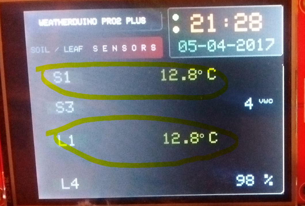

It's working on Rx dedicated screen:
[attachment=975]

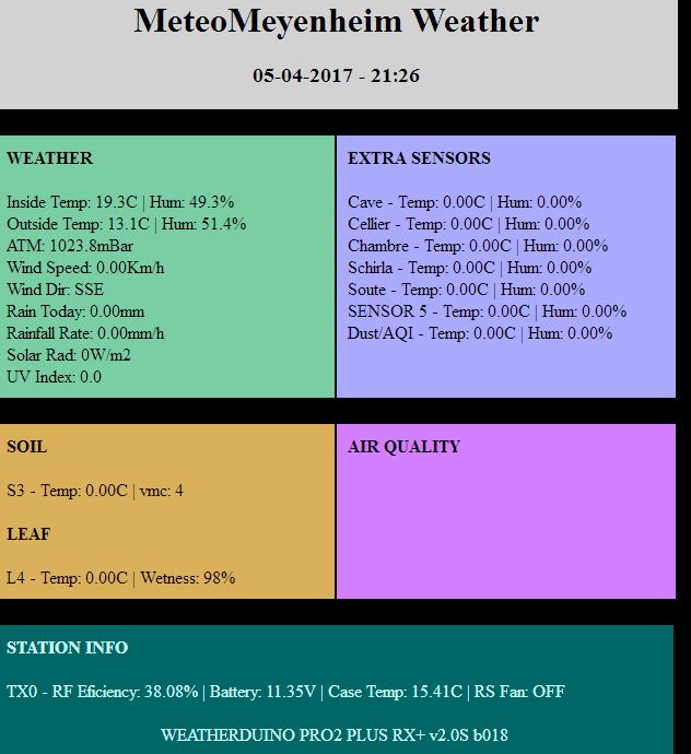

But on web server S1 and L1 temp data are missing:
[attachment=976]

Did i miss something in the config ?
I think it should perhaps be because i only define TempSensors (Soil/Leaf) and NO SoilMoist or LeafWet sensors !
#define SoilTempSensors_Source  { {0,0},{9,9},{9,9},{9,9} } #define LeafTempSensors_Source  { {0,1},{9,9},{9,9},{9,9} } #define SoilMoistSensors_Source { {9,9},{9,9},{0,2},{9,9} } #define LeafWetSensors_Source   { {9,9},{9,9},{9,9},{0,3} }

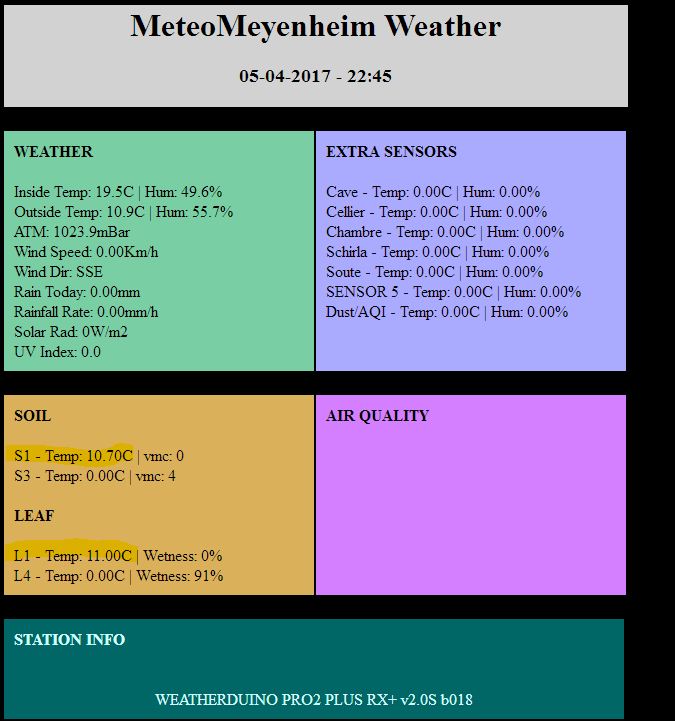

The solution :
In NET.ino line ~361 changed the test conditions (same as in D_TFT.ino line~341)
line ~361
 Content += "<br><table cellpadding=\"10\"><tr><td width=\"290\" valign=top bgcolor=\"#DBB05B\">";  Content += "<b>SOIL</b><br>";  for (byte i=0; i<4; i++)   {     if ((SoilTemp_Source [i][0] != 9) || (SoilMoist_Source[i][0] != 9))      {         Content += "<br>";         Content += SoilSensName[i];         Content += " - Temp: ";             Content += Soil_Data[i][0] / 10.0;         Content += "C | vmc: ";         Content += Soil_Data[i][1];      }   }  Content += "<br><br><b>LEAF</b><br>";  for (byte i=0; i<4; i++)   {     if ((LeafTemp_Source [i][0] != 9) || (LeafWet_Source[i][0] != 9))      {         Content += "<br>";         Content += LeafSensName[i];         Content += " - Temp: ";             Content += Leaf_Data[i][0] / 10.0;         Content += "C | Wetness: ";         Content += Leaf_Data[i][1];         Content += "%";              }       }
[attachment=977]
Perhaps there  some more code to add  to mask the unused values Rolleyes
