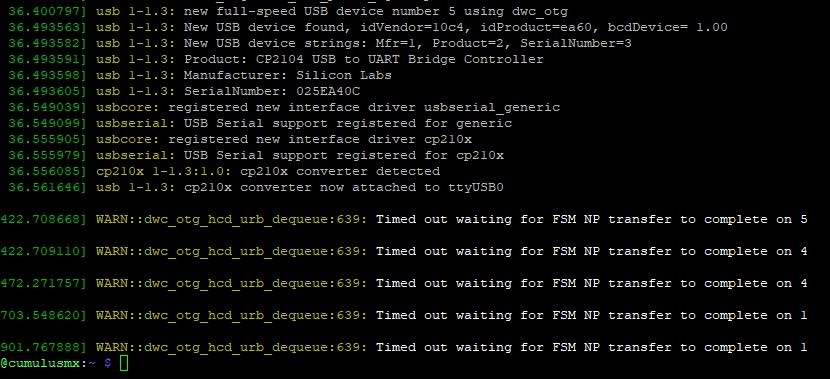

next try: connected the 4proRX directly to the LinuxMint notebook with arduino IDE and did a fresh sketch-upload with "Erase flash" before. After successful upload, i transferred the complete "data" folder to SPIFFS via ESP32 Sketch Data Upload Tool
i checked everything. is the correct USB connection in use (yes it is /dev/ttyUSB0 connected to cp210x)
when i reboot the rpi - restart cumulusMX, whats the output of Log:

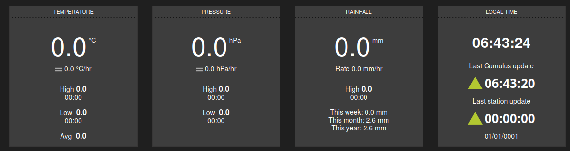

![[Image: image.png]](https://i.postimg.cc/Y9jpM6k8/image.png)
My next guess was, that i changed something in config.h, but i can´t find a bug. Pls find the config.h attached below. I did further investigation with direct usb connection and debug mode to see the comm. in Serial.Monitor of the IDE. I even did a debug-session with directly connected RX to the Notebook and Serial Monitor. If there´s interest, i´ll post the outcome here too.
Conclusio until now
So while sensor readings are displayed on the WD pro4RX, it seems to me, that the communication with cumulusMX in Davis Mode is completly gone. cumulusMX dashboard keeps empty with 0° and zero time. But there´s one interesting part: the AQMIII readings are displayed in CMX -> Extra Sensors -> Airlink Sensors.
