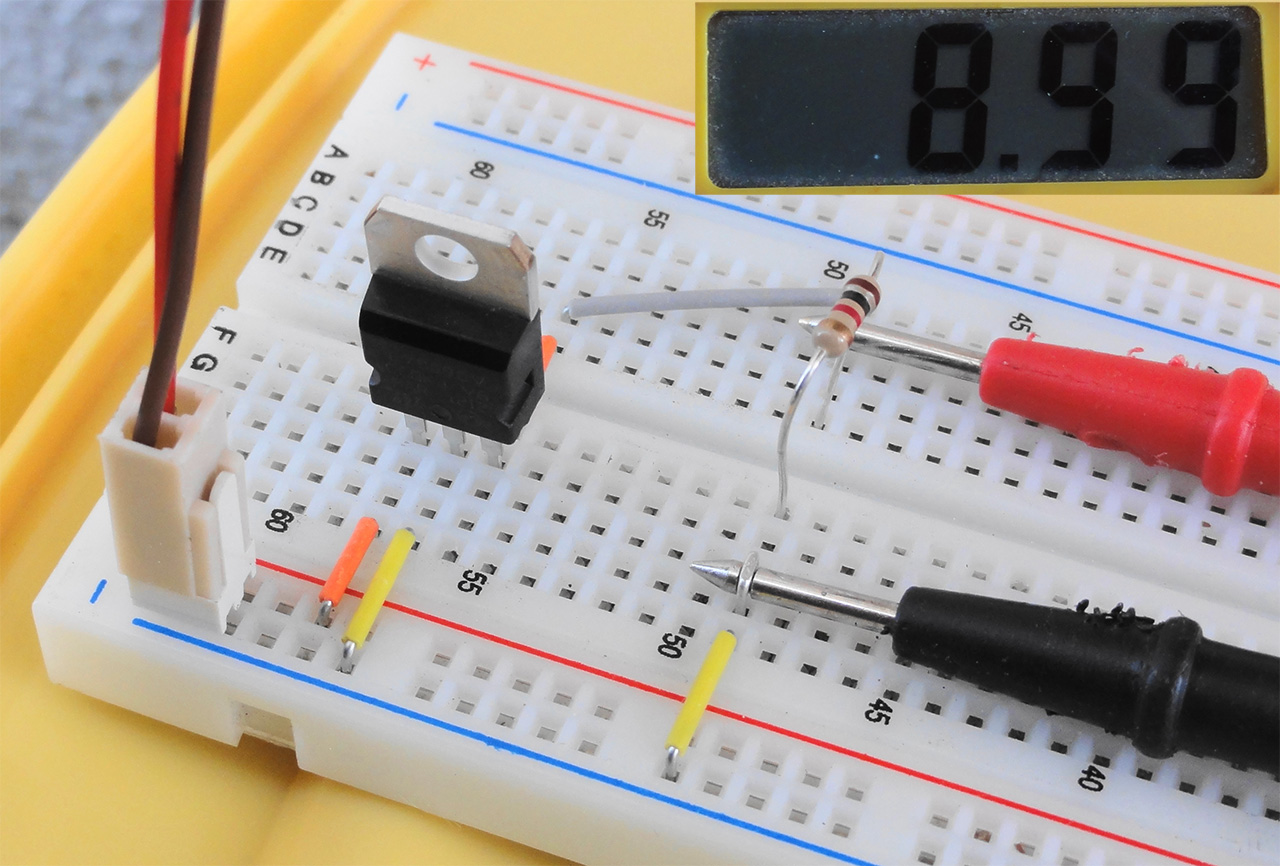

The Heatsink is on the TX's LM7809 for the Stevenson screen fan (and IIRC the 433mhz module).
(27-11-2014, 20:29)Live_Steam_Mad Wrote:  And / or a significant fraction of the power use is caused by running the PCB on board regulator at 12V instead of 9V (I saw a heatsink on one of the PCB's, can't remember if it was the TX or RX or both). That's my guess.
If you are concerned about the power loss at the 7809 regulator (less than 0.2W when the fan is not used), you can bypass it and feed the board with a 9V power supply.
As uncle bob said, the heatsink is only needed if you use a fan in your Radiation Shield. Even if you install a fan, it don't have to be always on. Software allows you to define on/off conditions.
