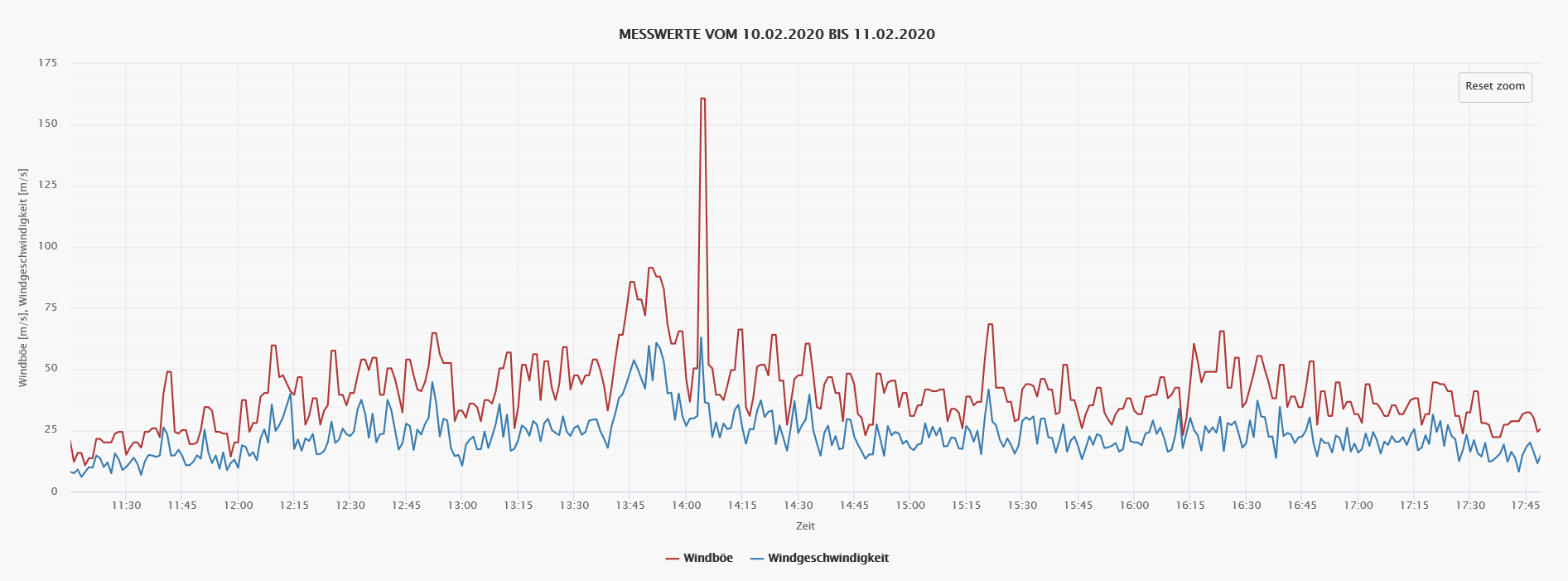

last monday as some of you might know we had stormy weather here.
The wind was (at least compared to what is normal here) quiet strong and I measured one single gust of about 160km/h.
See graph attached (note the units on the Y-Axis are wrong - it should be km/h).
From all I know it was a very strong gust and also some station here measured values in this range.
I'm using a FO anemometer mounted about 2.5m over the ground.
Config is like this:
Multipiliers in WeeWx are also correct.
Can you imagine any other sources influencing the reading besides of the FO Anemometer.
I can not say the measurement is wrong but I think the reading is too much. 130km/h or around that would seem more realistic.
