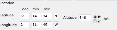

RE: Software Question - water01 - 26-08-2014
When putting in Lat and Long it says use tenth degrees so I assume that means mine should be
#define LATITUDE      511434        // Put here your Station latitude in tenths of degrees North
#define LONGITUDE     023149        // Put here your Station longitude in tenths of degrees East
although I am West of the Meridian so the second one may be wrong.
(26-08-2014, 12:19)Werk_AG Wrote:  Supposing your latitude is 51.14 degres North, just put 511
same for longitude: 2.32 degrees East, put 23
But I am West of the Meridian so what do I put in then as it states degrees East.
In Cumulus I have these settings
