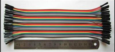

3- Take one of these Dupont Female to Female Jumper Wire, with no more than 20 to 25 cm, and remove a slice with ten wires, yes, ten wires...
[Image: DupondWires.jpg]
and put 8 of them in the RX boardconnector. The two remaining wires will be used latter for powering the TFT backlight (more on this, below).

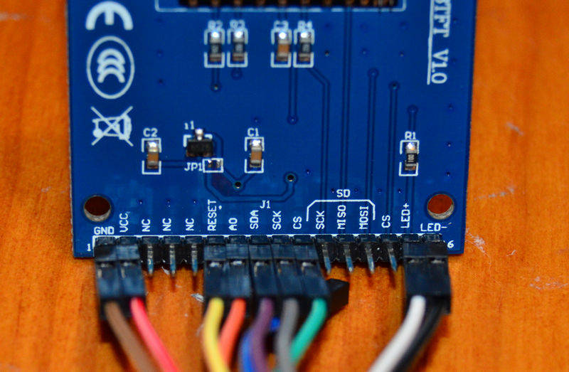

4- Now, connect the eight wires coming from the TFT connector to the TFT display.
Following the colors on the image above (you may use wires with other colors, just make sure you connect them right).
Brown wire to GND
Red wire to VCC
Orange wire to AO (DC)
Yellow wire to Reset
Green wire to CS
Blue wire - not used
Violet wire to SDA (MOSI)
Grey wire to SCK
[Image: WDPro2_TFT_connector4.jpg]

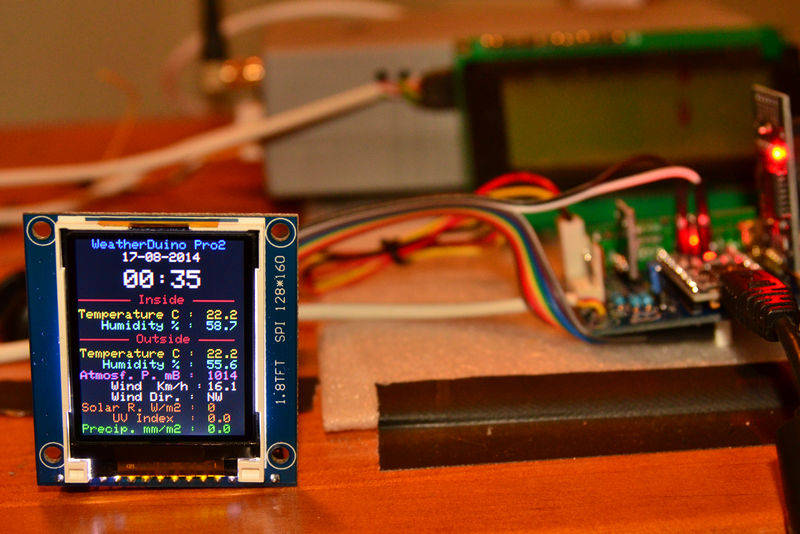

Now your weather station have a beautifull color screen!
It's time to play with the SW1 momentary switch (have you connected it to the RX board?). Try a brief toutch and a long toutch... if you find something, don't tell anyone, it's secret Cool. Enjoy!!!
Now, put this all in a plastic project box, and you get this...
[Image: WDpro2_receiver.jpg]
