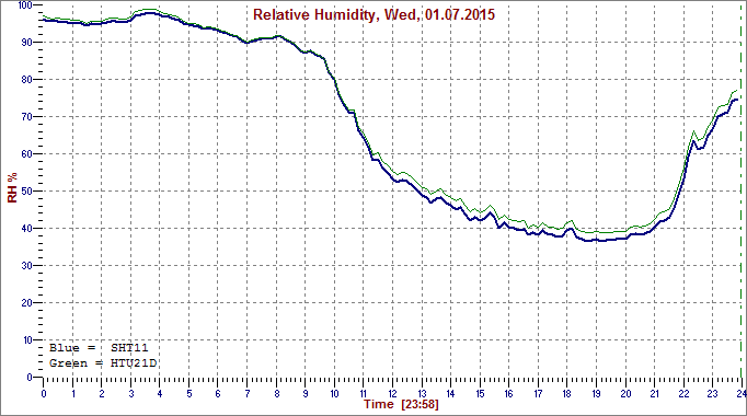

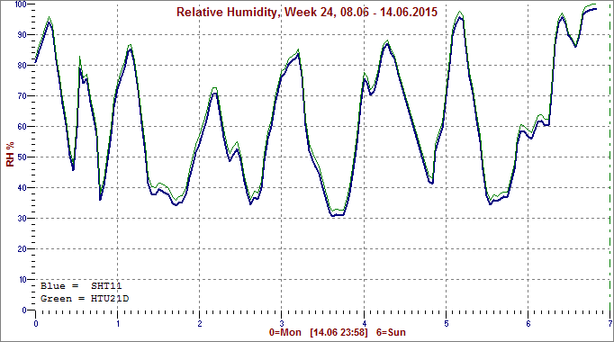

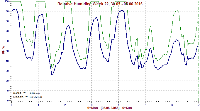

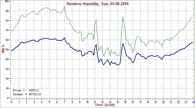

My experience about HTU21 are not so good for outside usage. I have several humidity sensors outside and normally they last less than one year. One example is below, there is SHT11 and HTU21 sensor inside stevenson shield, fan aspirated H24. First picture is from July 2015, both sensors have the same readings. The second picture is about one year later, HTU21 sensor is giving much higher values. During the winter time HTU21 was showing 100%. For inside use HTU21 is very good, but for outside only Sensirion sensors have been working more than one year. Now testing SHT31 and that looks promising.
Mikko.

RE: HTU21D Temperature / Humidity sensor - hvalentim - 06-06-2016
Just by looking at the graphs, one month apart (similar season), without further knowledge, for me (not having access to further elements, which I am sure you have) it would be more easy to hypothesize it is the Sensirion underreading in 2016.
RE: HTU21D Temperature / Humidity sensor - Mikko - 06-06-2016
It's difficult to say what is the absolute truth. My personal feeling is that Sensirion is closer to the real value. The following graphs have data for one week. I am planning to buy Vaisala sensor (less than 400€) in order to have reliable values in case SHT31 does not work well. I started with HIH-4000 sensors more than ten years ago but they also lasted only one winter season.
