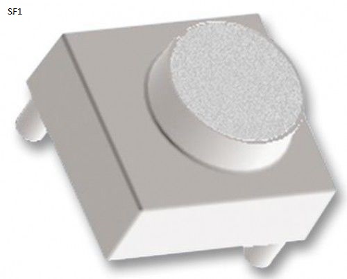

SF1 Item No 1390624 for SHT1x series sensors

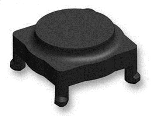

SF2 Item No 1892485 for SHT2x series sensors
These are sensor filter caps which fit over the sensors and supposedly helps prevent ingress of moisture and other things.
SF1 come with 2 legs which allow for through PCB mounting, as my PCB didn't have these holes, the legs where care fully cut of and I used some clear silicon sealant being VERY CAREFULL not get any in/on the sensor itself, using this sealant not holds the cap in place but also seals it, ( Epoxy resin can also be used ) The sensor was rewired, rehoused and connected to the tx.
Readings gained where similar to the internal sensor so at least I was getting some near normal readings from it, The sensor is now back outside and seems to be working well, having compared its readings to other local weather stations on weather underground.

Great minds think alike: I have an SF1 filter cap sitting on my workbench, awaiting installation on my SHT11 next time I have the sensors down from the pole.
For Australian WeatherDuino builders, RS Components have them for $2.50 each (ex GST) and at present, offer free shipping. The part number is 667-5275.
