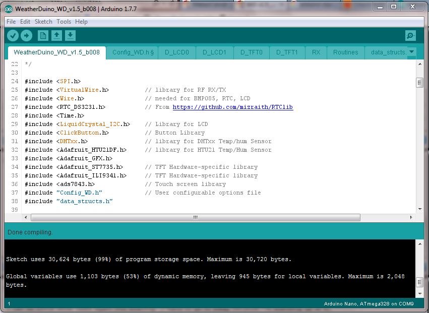

I'm trying to compile the last WD software with:
#define DisplayType 1 // 0= TFT 160x128 ST7735, 1= TFT 320x240 ILI9341, 4= 20x4 LCD, 5= 16x2 LCD
But i have an error (in french)
Quote:Le croquis utilise 30 962 octets (100%) de l'espace de stockage de programmes. Le maximum est de 30 720 octets.
Les variables globales utilisent 1 294 octets (63%) de mémoire dynamique, ce qui laisse 754 octets pour les variables locales. Le maximum est de 2 048 octets.
This mean that the 'sketch' is to big !!
Could someone advice me what to do please ?
RE: WD v1.5_b008 compile issues - werk_ag - 11-01-2016
Arduino IDE version?
Are you using the supplied libraries?
Quote:Sketch uses 30,624 bytes (99%) of program storage space. Maximum is 30,720 bytes.
Global variables use 1,103 bytes (53%) of dynamic memory, leaving 945 bytes for local variables. Maximum is 2,048 bytes.

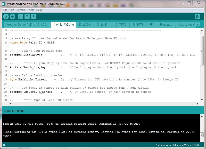

RE: WD v1.5_b008 compile issues - laulau - 11-01-2016
It' ok now with the updated library. Sketch size : 30 284 octets (98%)
But when i try to add the touch display (#define Touch_Display 1)
Sketch is too big again : 31 008 octets (100%)
(Maximum is 30 720 octets)
If i add the local temp sensor it's even worse : 31 652 octets (103%)
Is it working for you ?
RE: WD v1.5_b008 compile issues - werk_ag - 12-01-2016
Yes, it is.
Please check again, if you are using the supplied Adafruit_ILI9341 library.
Newer versions may be greater and use more memory.
I'm using Arduino IDE 1.7.7 from: http://www.arduino.org/software
Seems they are using compiler directives, more optimized for size.
I checked with Arduino IDE 1.6.7 from: https://www.arduino.cc/en/Main/Software
and it fails!
The software download page was updated: Now is pointed that Arduino IDE 1.7.x is required
The split of the Arduino Team, is starting to cause troubles...Confused

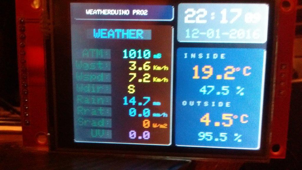

RE: WD v1.5_b008 compile issues - laulau - 12-01-2016
Latest IDE (178) installed, latest WD library folder added and latest WD project compiled succesfully!
First Wireless Display working well now.
Thanks for your prompt useful replies.
