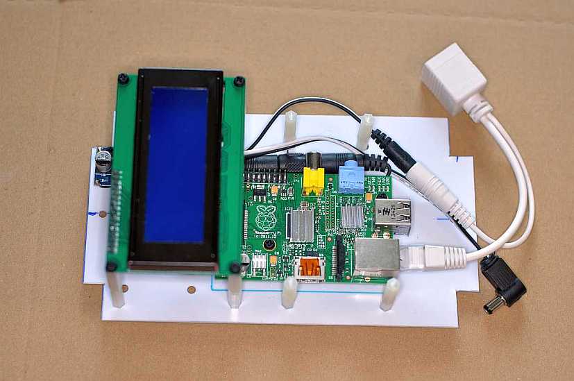

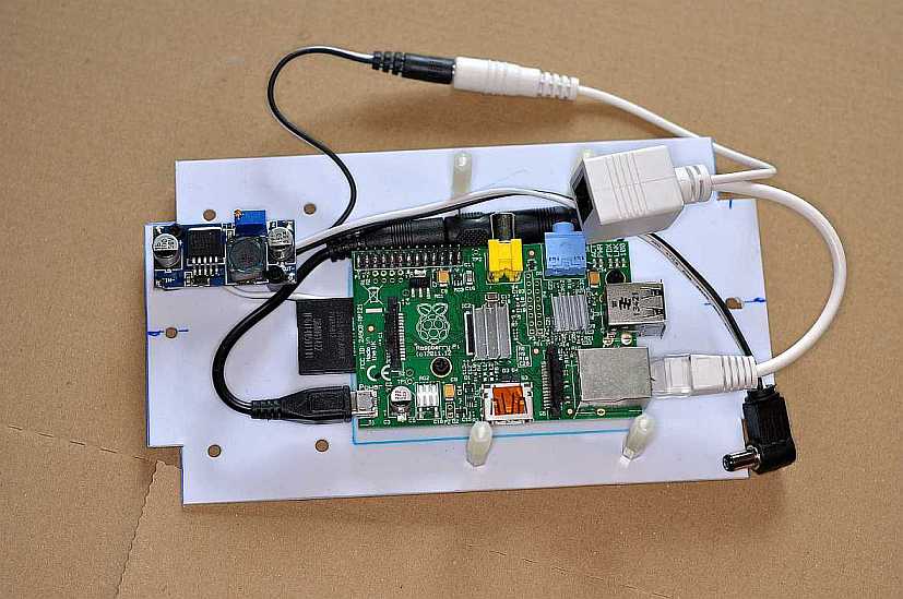

This is my project of WeatherDuino Pro2 for CumulusMX. First picture shows motherboard with Rapberry Pi and voltage converter. I am using Power over Ethernet (12V) and converter makes 5V for Rpi. RX board is getting 12V directly from PoE.
[Image: wdpro01.jpg]
Now LCD 20x4 is set up

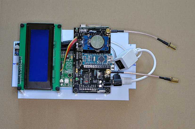

This picture adds RX board
[Image: wdpro03.jpg]
