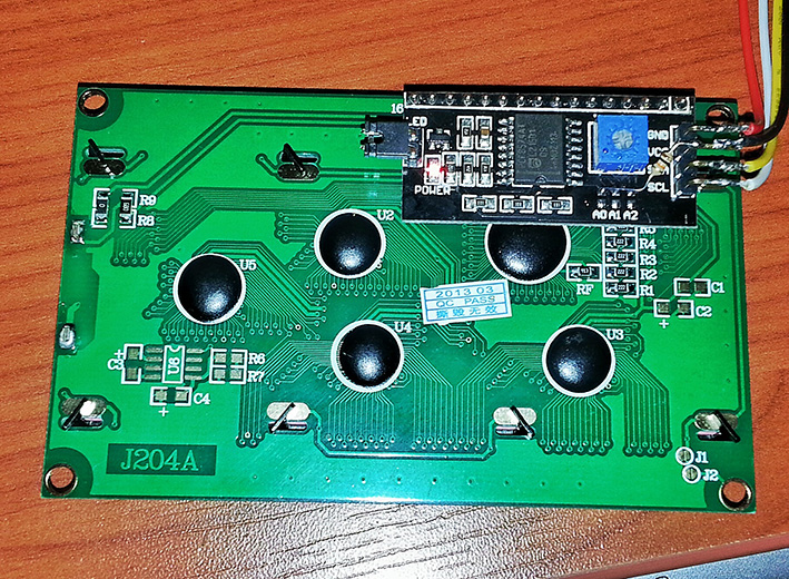

Certainly the backpack of your LCD is different from the most comum serial LCD modules, but what is important is that it is working.
Could you post a picture of the back of your LCD? It may help others that had bought a similar LCD.

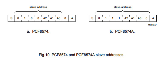

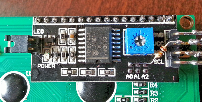

RE: LCD nothing displays - RX boards. - hamix - 24-05-2015
I've attached three photos: Backside of LCD module and i2c to parallel converter module and i2c addresses of PCF8574 familiy.
According to the daha sheet there is a diffrence between PCF8574 and PCF8574A.
A4 and A5 address lines of PCF8574 are 0, but these lines are 1 for PCF8574A.
So, if i2c to parallel module used a PCF8547, the i2c address is 27h (39d) but used a PCF8574A the i2c address must be 3Fh (63d).
Regards.
RE: LCD nothing displays - RX boards. - werk_ag - 24-05-2015
Thanks for the pics and for the valuable information about the diferences between PCF8574 and PCF8574A.
Just for curiosity: You have added the resistor between A0 and VCC for any purpose, or it already was there?
RE: LCD nothing displays - RX boards. - hamix - 25-05-2015
(24-05-2015, 21:39)Werk_AG Wrote:  Just for curiosity: You have added the resistor between A0 and VCC for any purpose, or it already was there?
Just written "Pullup resistors are not needed" at the PCF8547 data sheet from Texas Instruments. But I read this "Pullup resistors are needed" Blush
