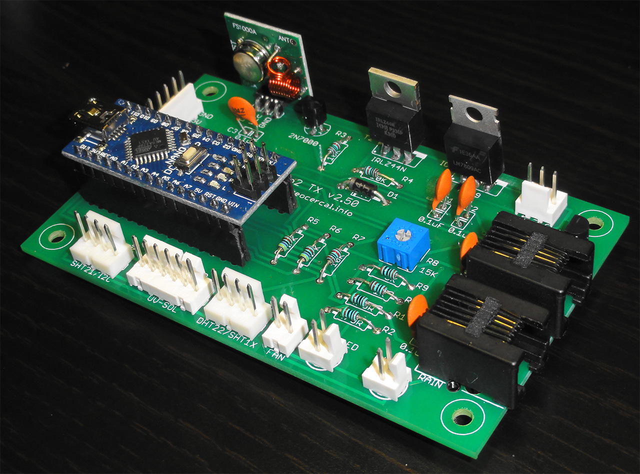

While performing a continuity test between Source and Gate pins of IRL244N of an assembled TX Unit v. 2.5 I see current flowing. I supposed this should not happen (?) and I guess I may have damaged the component by applying excessive heat while soldering.
Am I correct to assume this may be the cause of effects I am experiencing such as:
• LEDs being fed ~6v while 12v supply is ON
• FAN being feed 4 and something volts while no 12v source is present
• 7809 regulator having a reading of 4 something volts on the Output side while the board is being powered by USB only
I ask because yesterday I assembled my first unit and while testing (just with a DHT22) I discovered the TX led was not blinking, blown by excessive voltage (I have 510 Ohm resistors applied to R1 and R2). Having searched for a bridge in solder again and again and again and once more with no luck, I am now looking for a problem with components. The Diode seems to be OK.
Activating local debug over serial shows temperature and humidity being read.
The TX led blinks (switches off and on).
Any help/ideas would be much appreciated.

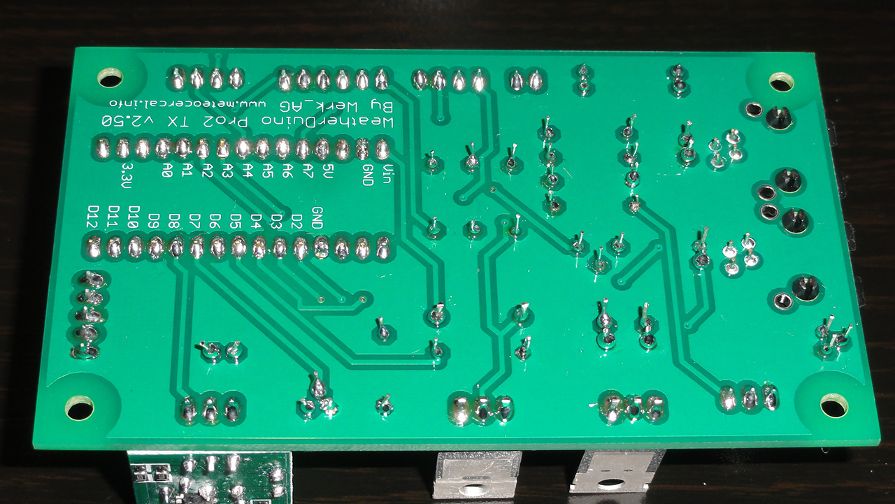

First of all, judging by the photos you have done a really nice soldering job.
It's not easy causing damage to the IRL244N just by soldering it.
Maybe, there isn't any major problem. What kind of LED are you using? Some 3mm leds works with very low current and blow easily with 15mA, if you are using this kind of LED, increase R1 and R2 to 2.2K
You can do a small test with your LED's, with just a 9V battery. Connect them with the 510 Ohm resistor you are using, if they work well and don't blow, then they also will work on the TX board.
