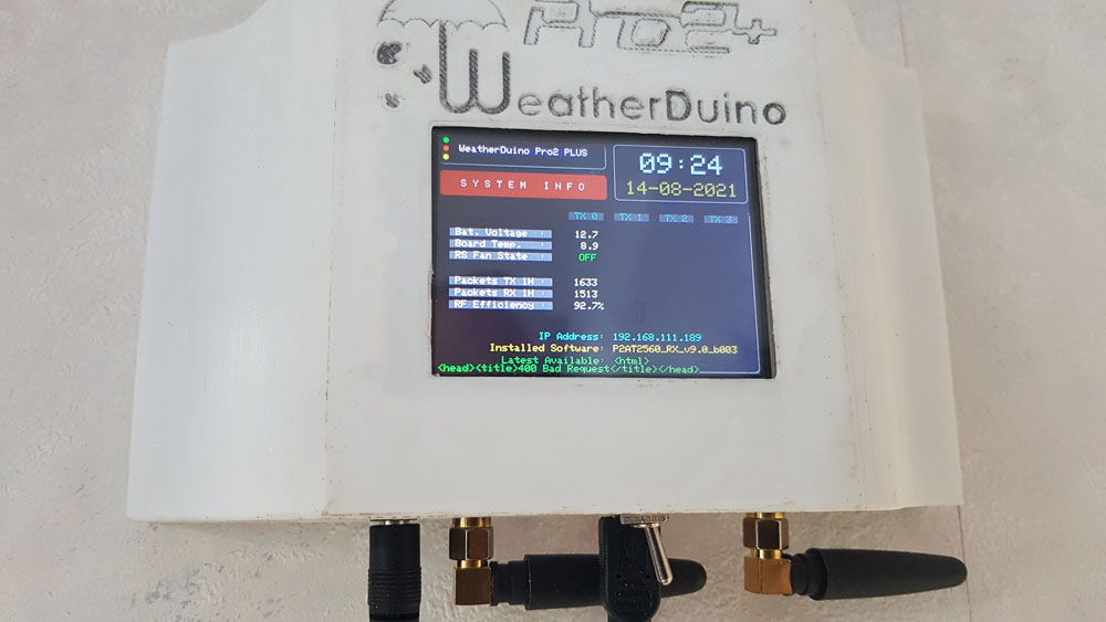

There appears to be a problem with the receiver accessing the latest version information over the net.
I receive a "400 Bad Request" reply complete with HTML tags.
Ian

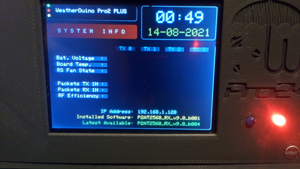

RE: Latest version error - werk_ag - 14-08-2021
Hello Ian,
Can you please tell what is your station name, for me to check what is sent to the WeatherDuino server when checking for the latest version.

On the server logs, I can see many Pro2 PLUS systems getting the latest version info correctly (two of them are from NZ).
The latest version check function is working for me too.
