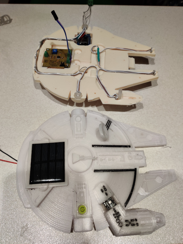

Today I would like to introduce you to my latest creation for my weather station, the Millenium Falcon from Star Wars as a housing for the solar radiation and UV sensor kit for the WeatherDuino weather station.

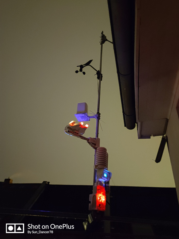

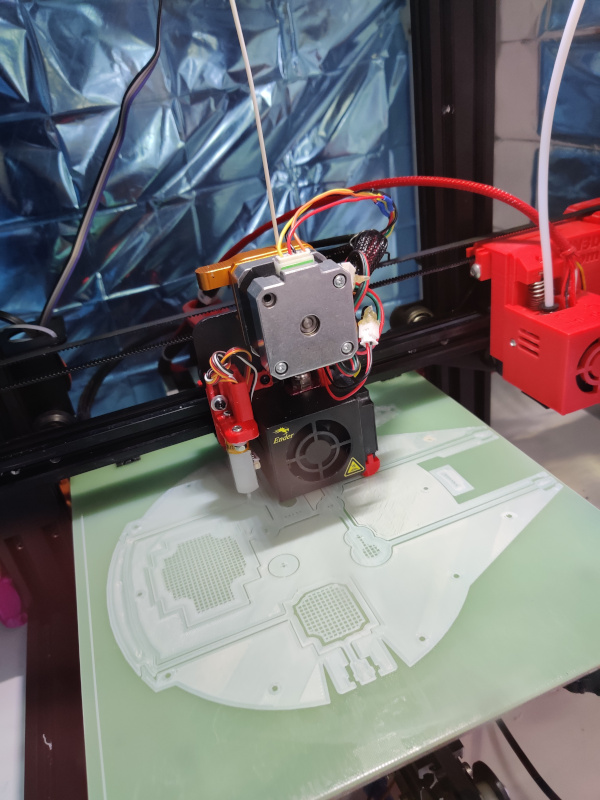

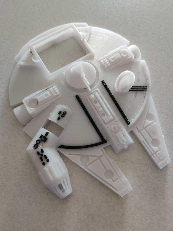

The Falcon is made with the 3D printer and, in addition to the solar panel and UV sensor, is equipped with a Wemos D1 mini that lights up a few neopixels for nighttime lighting.
Here are the neopixel in action   https://youtu.be/7Qw6SBU6rTo

Hello Werk_AG,
Sometimes I'm just a playful little boy Smile
I printed the lower part with ASA filament, the upper part with PETG. ASA filament is a bit stubborn, it warps up very quickly and the upper half just wouldn't work, so it was printed with PETG. I sealed both parts with a sticky sealant, hot glue and at the end with a lot of primer and spray paint. After several days of rain and snow, I can say that the housing is tight. Smile
