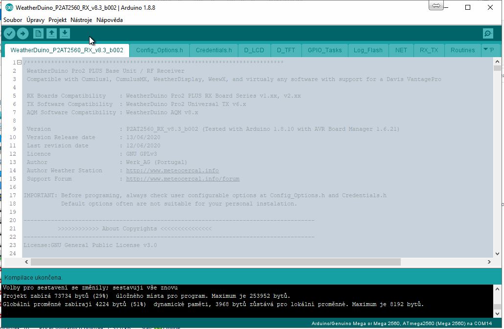

Hello again,
I verified the compilation without any configuration intervention on my PC with Win10, Arduino IDE 1.8.8, Arduino AVR Boards 1.6.21.
The result is without any problems...
Are you sure you copied all the libraries to the right folder?
At me: C:/Users/hornychz/Documents/Arduino/libraries
I don't understand why your compilation points to GitHub?
